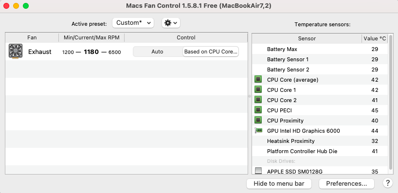

FaceTime works fine; I have a different app called ‘macs fan control’ and it reads the temperature at 31’-31’C ..

The temperature readings say the temperature is between 31-32’ C.. is that too much?

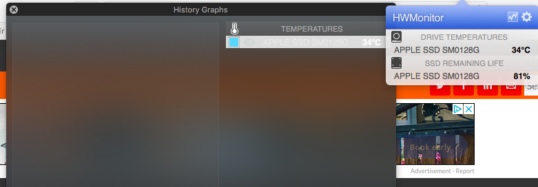

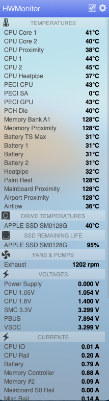

Jordysack, Macs Fan control is not enought, for example on my computer it reads only some sensors like shown in pic 1. But HW Monitor gives a more complete information like shown in pic2. And in my case, this was caused by liquid damage. It didn't start immediately, but after a few weeks.
I dont know why this is, so I installed hwmonitor and its not showing me all the info you're seeing
