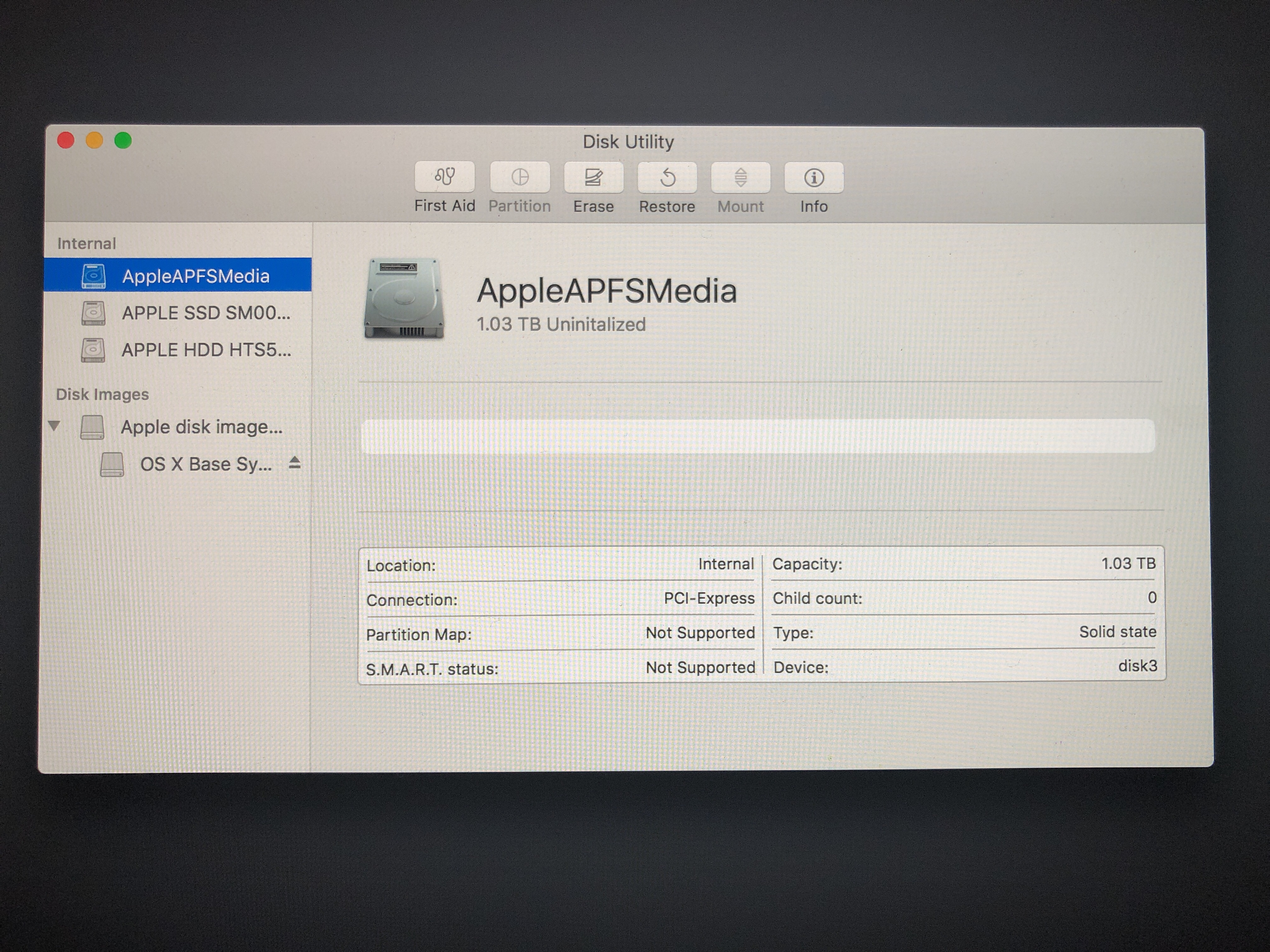

I have an iMac 21.5” 4K. I went to use it and the apple image came up like it does when it resets or upgrades. This was strange to me as I had not used the computer for two days prior to this. As I tried figuring out what to do I went to apple and read I could press command R. I then tried resetting the iMac to factory settings and while doing so I erased my hard drive. I never backed it up, and now I don’t see my hard drive and I am not sure what I have just done. I have tried to reinstall IOS but I don’t see my drive any more. I only see what’s below. Did I just kill my iMac? Any help would be appreciated.
[doublepost=1558610865][/doublepost] image.jpg

The hard drive may still be ok.
What happens if you boot to "command R" (recovery partition)?
Do you get to the internet utilities?
If that doesn't work, try booting to INTERNET recovery.
To get there, reboot and hold down "command-OPTION-R".
Can you get there?
Try these things, and tell us what happens.
It WAS NOT A GOOD IDEA to be trying to do this without a backup.
Chances are, if you've erased your personal stuff on the internal drive, then you're not going to "get it back".
