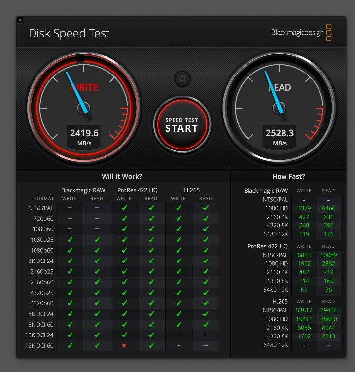

Recently, I built a NVME external thunderbolt 3 drive to use as the startup drive for iMac 2019. BlackMagic rates it at 2300MB/s. Everything is much faster than before on the iMac 2019, but it is still not as responsive as iMac 2015. I really don't know why. 😭 Any idea??? 😅

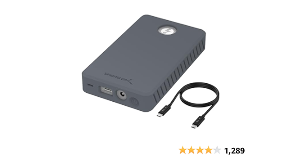

Since iMac 2015 is more responsive, I want to use the external drive as the startup drive for iMac 2015 as well, because I have a lot of files in the drive. It is nice to be able to keep the files in one drive and use it on both iMac. But iMac 2015 has only thunderbolt 2. I bought a thunderbolt 3 to thunderbolt 2 adapter and a thunderbolt 2 cable. Then I found out that the external thunderbolt drive needs to be self-powered.😅 There are not many options for a self-powered NVME thunderbolt enclosure. I am in EU. The one that I find is SABRENT Thunderbolt 3 to Dual NVMe M.2 SSD Tool-Free Enclosure, which is twice more expensive than if bought in the US!!!

Currently, I am using the thunderbolt 3 NVMe external drive as the boot drive for the iMac 2019. BlackMagic rates it over 2300MB/s for both read and write. I did exactly what you suggested. I erased and formatted the drive with APFS and cloned it with CarbonCopyCloner. The speed does improve a lot. But it is still slower than iMac 2015! It was not usable, but now it is sluggish but bearable.
