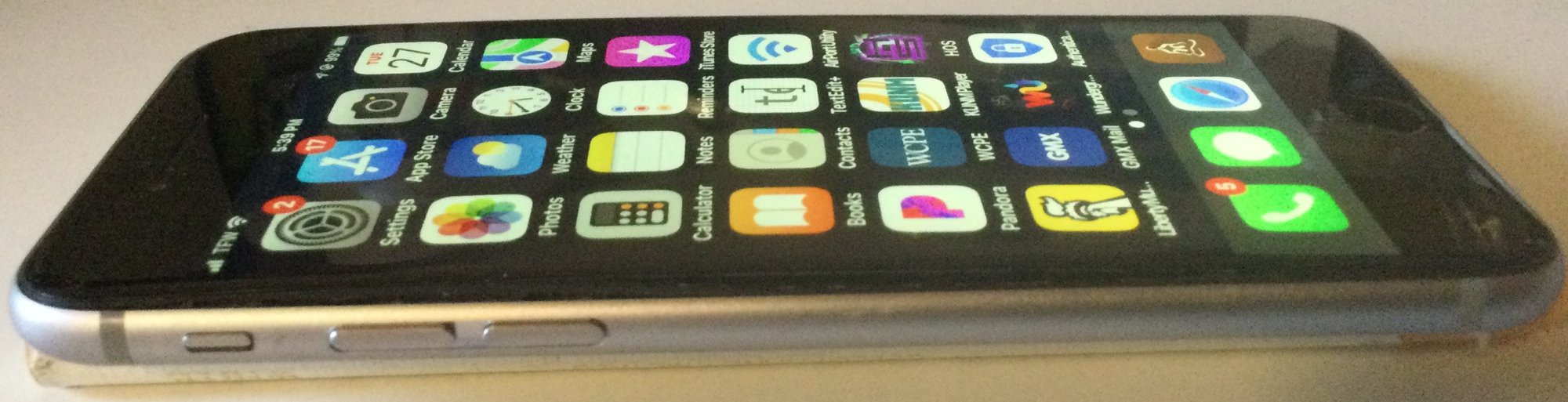

I've just noticed that the battery in my iPhone 6s seems to have swollen. I tried to take a photo of it; it's a little hard to see, but if you look at the upper edge it's curved. It looks like the screen might pop off the phone.
I don't know when or how this happened. I just noticed it, don't think it was like this earlier today. I don't use the iPhone a lot, but I was on hold with it for over an hour earlier today (a government agency). But I've had occasional long calls before, with no problem.
I had a similar problem with my MacBook Pro a while back, and realized it was because I'd kept it plugged in all the time. The battery needed to be cycled, and once I did that aggressively a few times the swelling went away. The iPhone is not usually connected to power, only when it needs recharging. Sometimes it gets down to 20% and complains, runs slow, so then I plug it in to charge. So it's been getting cycled pretty regularly.
In Settings > Battery, it says Maximum Capacity 100%. And "Your battery is currently supporting peak performance." I connected the phone to my MacBook Pro and checked it with coconutBattery, which said it still has 100% design capacity. iMazing says "Your battery health is excellent."
Anybody have any idea what's happening here, and what I can do about it? Will discharging the battery fix it? Is there a way to prevent the phone sleeping so the battery will discharge?
Or do I need to replace the battery? Even though it seems to be in excellent health?

I'd immediately shut the iPhone off and remove the battery before your display cracks. Happened to me.
At least unscrew/lift off the display. Then look for a replacement battery.
Or, get it replaced by Apple asap for $69. But I'd contact them before. You probably shouldn't ship it in this condition.
EDIT: In any case, if you don't have iCloud backup enabled, create a local backup via USB as long as the iPhone still works.

The capacity % in iOS is a very rough estimate - don't rely on it. When you have a catastrophic battery failure like this, it's not going to detect it.
There is no way to reverse this - you need to replace the battery.

Thanks, all, for your prompt replies and suggestions. I don't really need a new phone; this one does all I need. At 79, I'm kind of obsolete myself; I get along okay with a 2014 MacBook Pro and High Sierra. So I took it to a local shop who replaced the battery for $60. They said they could do it in 45 minutes, but I left it overnight, picked it up today, it works fine.
