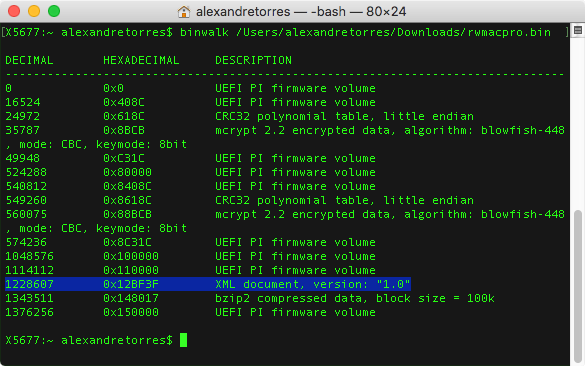

@macagain dumped his BootROM. It's MP51.0085.B00 version, have all the identifiers, Base_XX in the correct place, but have trash/logs/plists in the NVRAM.
I did the 138.0.0.0.0 reconstructed BootROM, but he can't enter the Firmware Programming Mode.
