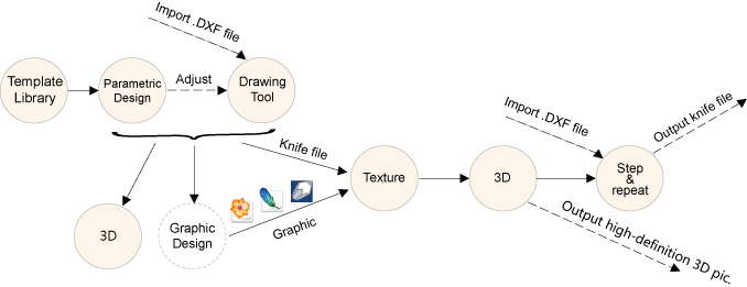

workflow of packaging design
this is the workflow of packaging design
