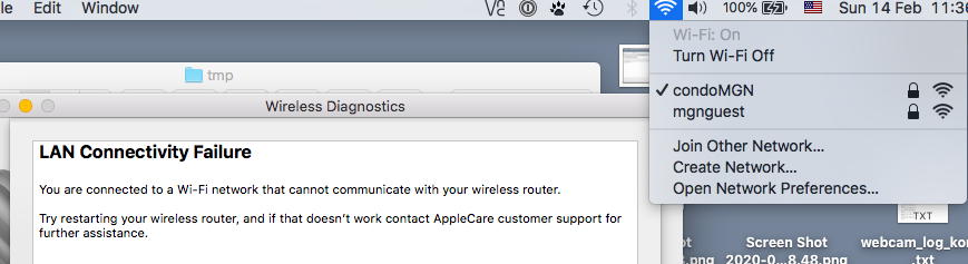

In order to find out what was up I decided to run Wireless Diagnostics. The first thing I looked at was the "Assistant", which told me: "You are connected to a Wi-Fi network that cannot communicate with your wireless router." And yet, at that very moment, the MBA was indeed connected to the router via WiFi, was connected to the Internet and was able to examine the Airport's configuration using the AirPort Utility.
Question: What, exactly, does Wireless Diagnostics mean by: You are connected to a Wi-Fi network that cannot communicate with your wireless router.

The white MacBook gave me the same answer from the "Assistant": "You are connected to a Wi-Fi network that cannot communicate with your wireless router."

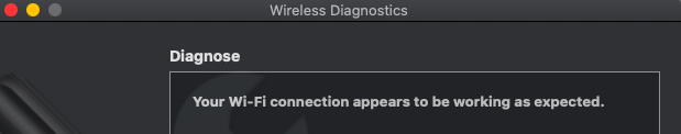

The 2017 MBA gave a completely different assessment: "Your Wi-Fi connection appears to be working as expected."
Question: Why does Wireless Diagnostics on the newer MBA tell me that the network is fine while on the older MBs it tells me that they cannot communicate with the router?
