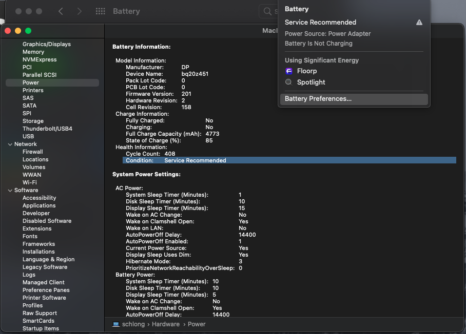

For the past 3 or so months I've left my MacbookPro9,2 plugged in and unused as I've gotten better machines to work with. Something came up today though and I need this Mac to work again temporarily, which is when I discover that the battery in this thing doesn't really want to work anymore as it instantly shuts down the device as soon as I pulled out the magsafe cable.
The battery indicator is stuck at 85% w/ the not charging symbol. I've tried a SMC reset which does nothing and also tried removing the battery physically, booting without the battery, then shuts down and replugging it in... which also does nothing. I don't have a spare battery on hand to test if it's really the battery so any guidance would be very much appreciated. Thank you.

I've taken it out to inspect it as recommended and there's nothing wrong with it from the outside as far as I can tell. I guess the battery cells inside might be dead though, shame if that's the case.

It sounds to me as though the battery is dead, and may need to be replaced, although, as @smirking has already remarked in his excellent post, the machine will work perfectly well without the battery as long as it is connected to an electrical power outlet.
