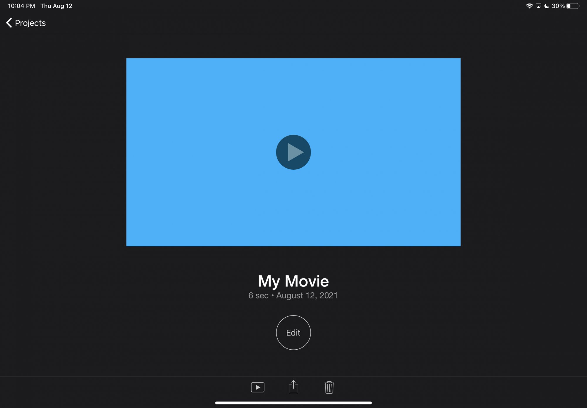

Ok, here's the deal (just tested this). If you play your video within iMovie and use the play button that's superimposed on the video itself, it will NOT play the video on the TV (it's sound only). You have to press the play button at the BOTTOM of the app.

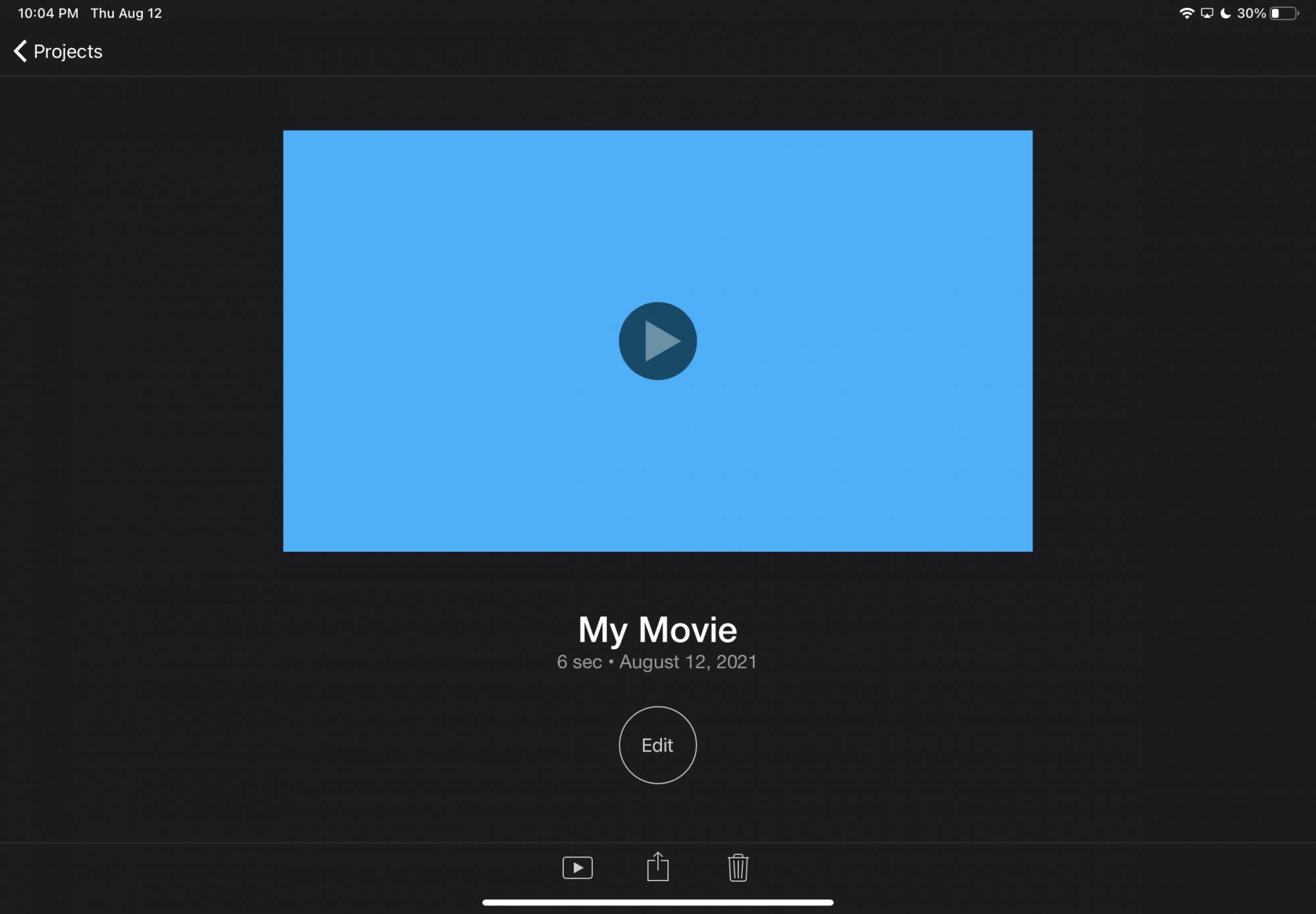

Thanks for trying this. Mine will not play either way. When I hit either play button, just goes to black screen. I also saved the video to photos and tried to play it from there. No go. I’m so frustrated with this. I guess I’ll be back on the phone with Apple again today. I’m afraid it’s a problem with my iPad. Maybe the connector inside is faulty.
