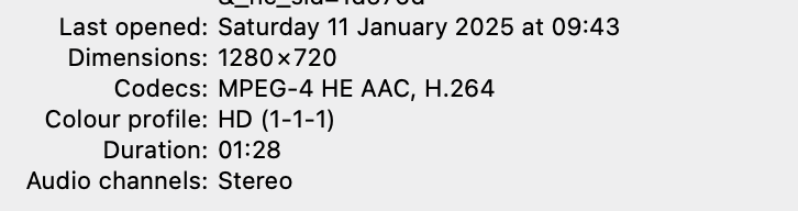

The video information is this:

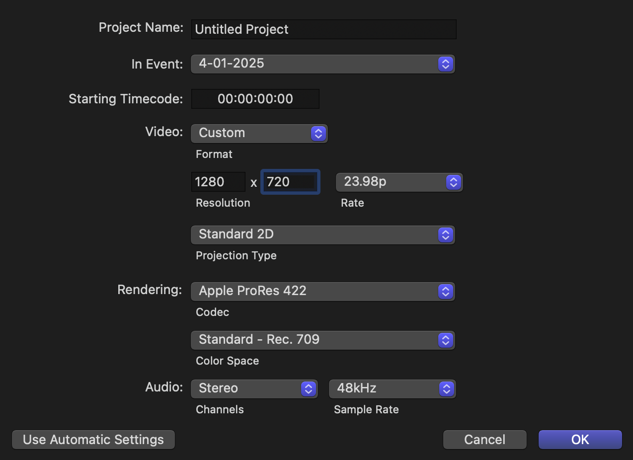

I import the video into Final Cut Pro using these settings:

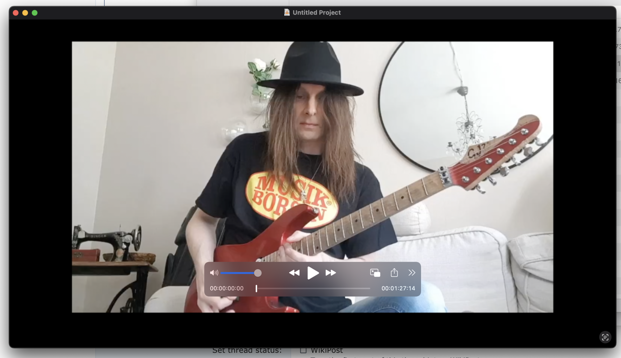

The unedited video looks like this in Quick Time Player -

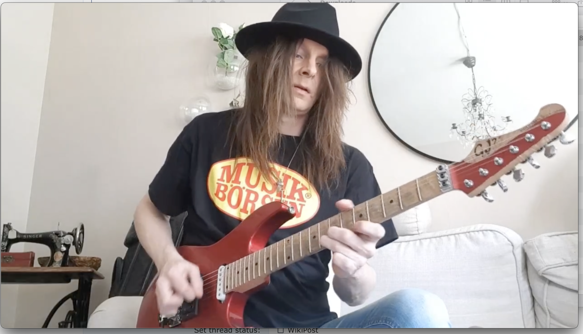

when I crop the video it looks like this:

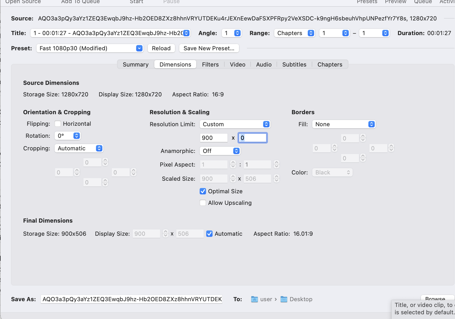

Thanks - it seems to work ok in Handbrake with these settings. If this is the wrong way I'm doing it, then please let me know.
