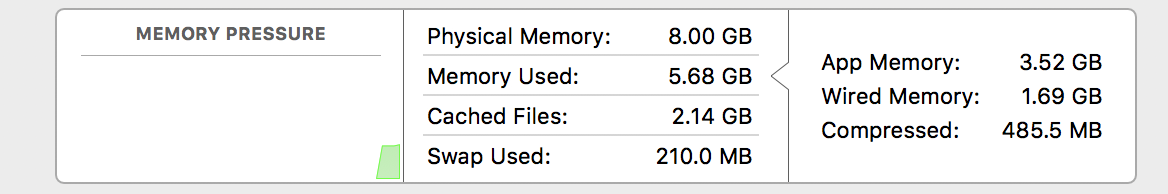

Here is how to tell... reboot then use it as you would normally most of the day. Then open Activity Monitor and click on the memory tab and look at memory pressure at the bottom. If that is in the green, you will likely not see much if any benefit from more RAM.
