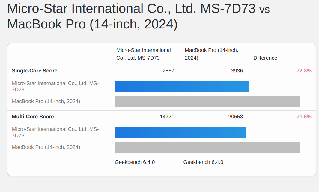

I am a Linux guy that recently got a M4 MBP for light dev work. Loving it btw.,
I am trying to understand bench marking results which, didn't make sense to me.
I compared my arch Linux desktop, in which -if I am interpreting the results correctly- the mbp whooped my Linux desktop. However, my Linux desktop compiles faster, and obviously runs games much better(no surprise there).
I did not expect the MBP to even be close to my desktop lol
How accurate is geekbench for these chips? is there another benchmark you'd recommend? preferably open source?
Also, is there any 'go-to' source code that you guys use to compile which is great for comparing to computers?
Many thanks!

Most benchmarks for compilation that I've seen, Apple Silicon tends to outcompete its x86 counterparts. Geekbench actually has a compilation subtest in it, look for "Clang". Here's an example for the two computers:
M4 Pro Clang (Multicore): 33942
7800X3d Clang (Mutlicore): 23497
Obviously here the M4 Pro is expected to compile things faster than the 7800X3D by quite a bit. You'd have to give a bit more detail as to your compiler/linker to know why the behavior you observed was different in your actual workflow. (Edit: I see you've replied since I started typing)
In general, Geekbench 6 gives a decent overview of a variety of different workloads. There are two things to keep in mind however. First, is that the multicore tests are not all equal. Some, like Clang, are embarrassingly parallel but others are deliberately designed to mimic "work-sharing" algorithms where the benefits of multiple cores plateaus after a while. Jon Poole, the head of Geekbench's dev Primate Labs, has stated this was to mimic real life desktop processes that many consumers commonly run and to avoid chipmakers and manufacturers from using Geekbench to push multicore systems that most users don't need or even cause them to buy worse systems (because lightly threaded and single threaded applications can suffer). However, if you are doing dev work that concern might apply less you to and instead of looking at the overall score which is a arithmetic and geometric mean of various subscores, you should focus on the subscores that matter most to you. Here is a manual for Geekbench and what each of the tests does:
The second thing is that Geekbench subtests are very, very short. Generally this favors x86 processors which often have very high instantaneous turbo boost modes that ARM and Apple lack, so that wouldn't exaggerate the Apple processor's but is still something to, again, keep in mind when looking at GB6 scores.

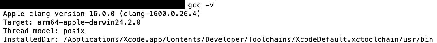

I did download and install, I noted that gcc was listed in the config. I must go check terminal history though, as I am not sure what it used now :/
when I type in gcc -v to get the "gcc" version, this is what I get:
So yeah it uses clang if you haven't actually got gcc installed and properly linked up, but you certainly might. Just thought I'd bring it up to double check. Regardless, given @galad's warning about the state of gcc on AARCH64 (I'm disappointed to hear it hasn't improved as much as one would like), maybe also try comparing clang compilation between the Mac and the PC to see how it performs?
