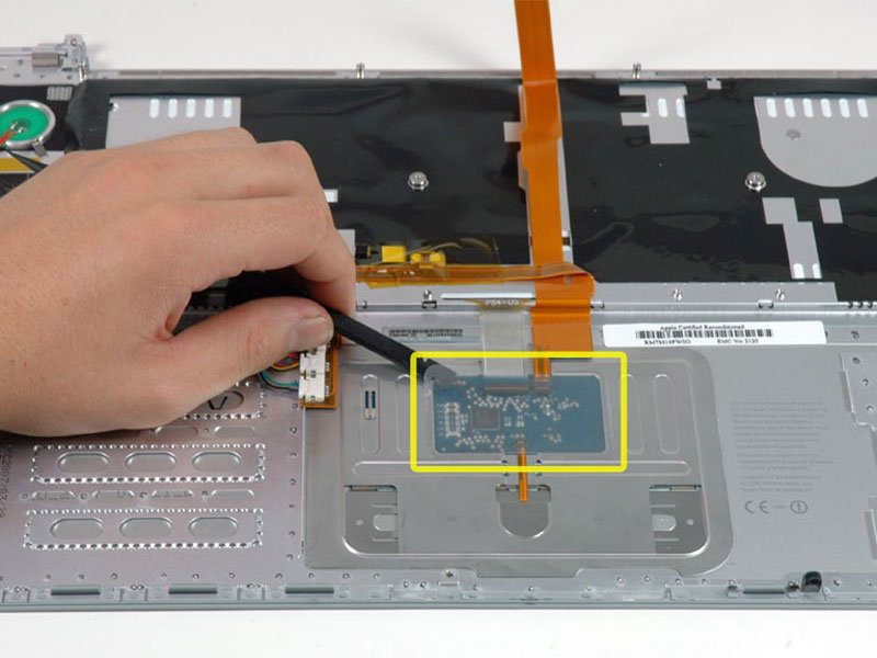

That would be the 15" Core 2 Duo released in 2006, discontinued in 2007, right? Keyboard failure is not a common problem with this model. My guess is either:
1. junk between the keys, causing problems. Remove with compressed air.
2. Worn out cable. It may need to be replaced.
iFixIt has a good repair guide. You can find it at

2.2GHz or 2,2 MBP? There is a difference. Anyways, if the keys are busted, take a look at iFixit. They have replacement keyboards.
