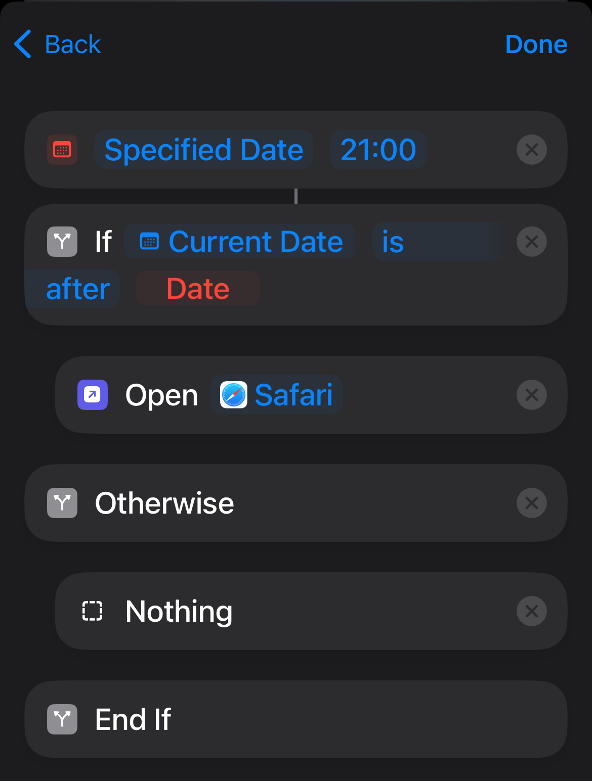

Example 1: 21:00 to Midnight
The "Specified Date" is the Date action. Just type in the time, which ends up being "[Today], 9:00 PM". The above doesn't open the app if you were to plug in after midnight, say at 01:00. The next example solves that problem.

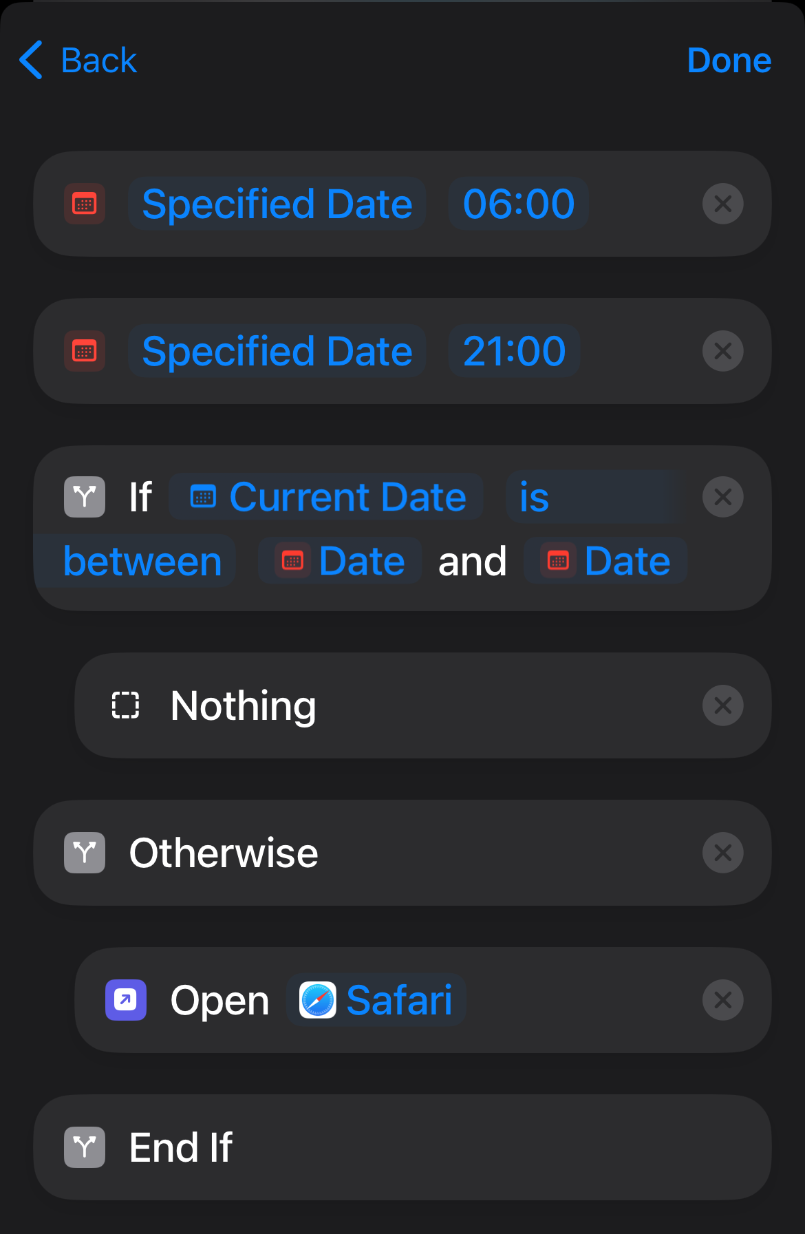

Example 2: 21:00 to 06:00
Here we are basically flipping the logic around. If it's between 06:00 and 21:00 (during the day), do nothing; otherwise, open the app. Another note/gotcha is that you need the leading 0 to indicate 24-hour time (06:00 is 6am, 6:00 is 6pm).

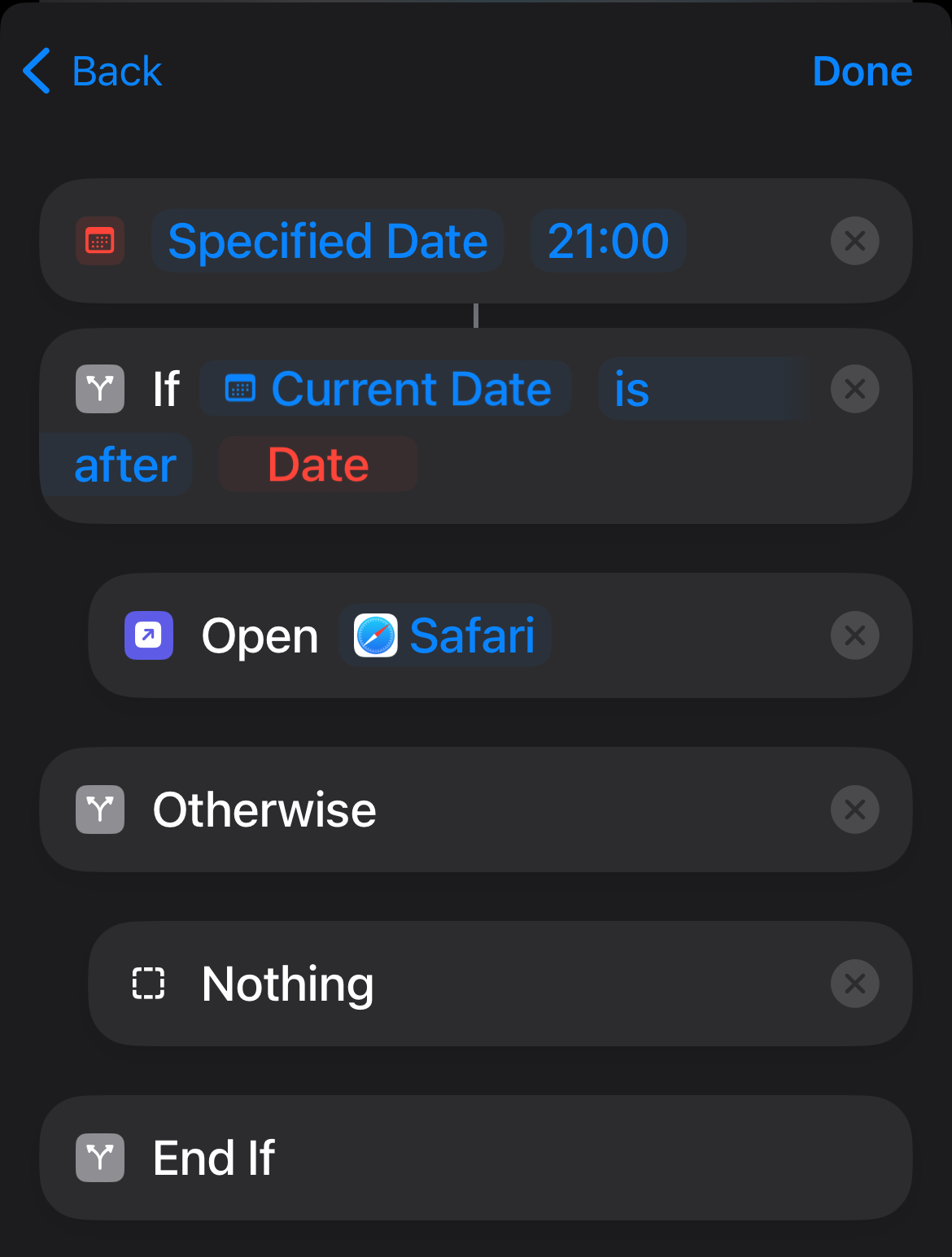

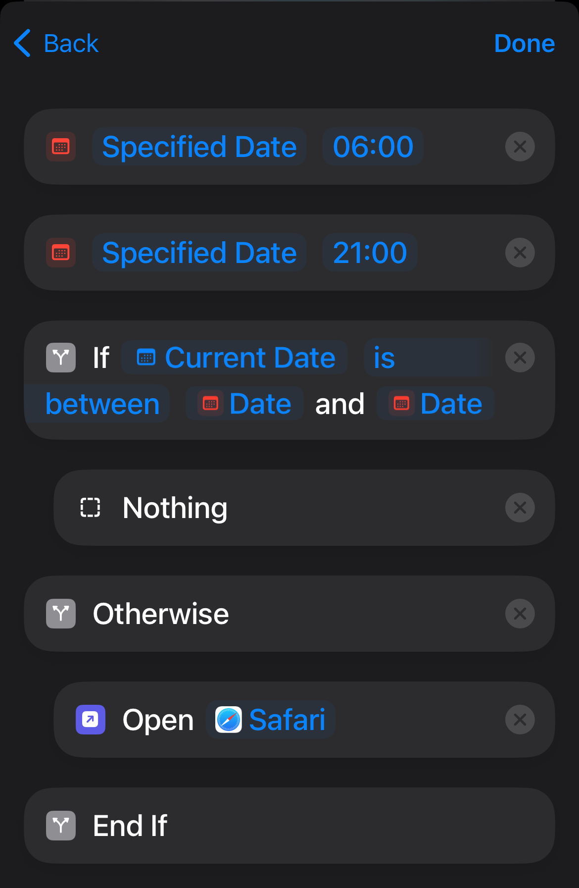

Should be possible.
