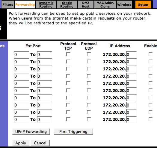

Hold on a second... The router should forward ports from the WAN IP (which may be 216.254.112.xxx) to an IP on the LAN (192.168.1.x). Now, let's say the PC's IP is 192.168.1.100, you would open the configuration page, and go to UPnP Forwarding and add a TCP port 3389 with the internal IP of 192.168.1.100. The Linksys will automatically detect the outside (WAN) IP, so there's no need to configure that.
Attached are some photos of mine, from a BEFW11S4.
EDIT: The first photo shows where UPnP Forwarding is located, and the second one is a custom port I use, SSH, and how I added it to the port list.
