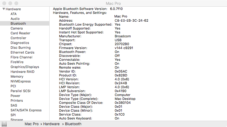

another question: when I pulled my old airport card (bcm94321MC), antenna wire 2 and 3 were connected. For BCM94322MC, which antenna wires do I connect?
@Squuiid
I suppose I have a 4.0 card, not sure. What would be the advantage of the 4.2 card over the 4.0?
