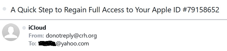

EDIT: I just got this email since making the above post. I got one a couple of days ago, same thing. I assumed it was a spoof so reported it as spam. Got it again now after monkeying with my phone.
I'm assuming this is not legit, anyone know for sure?

As for that email, it's a scam. Ignore/delete it.
Thanks. :D
