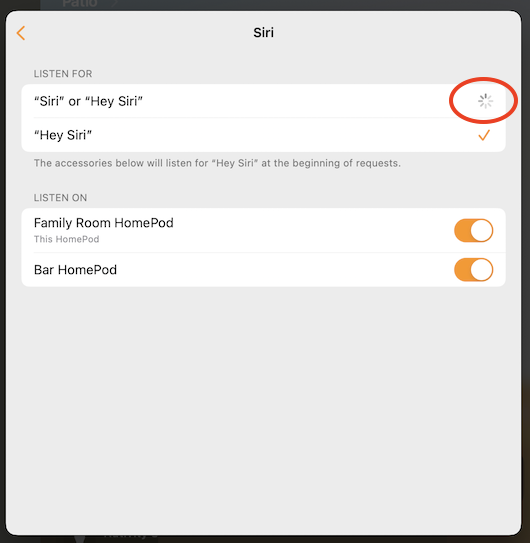

When I try switching Siri behavior, I get this:

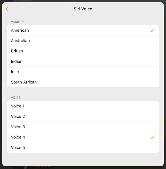

for quite some time. And I can’t make any changes here:
The UI simply won’t react to clicks on any voice selections.
Weird, sorry no use.
