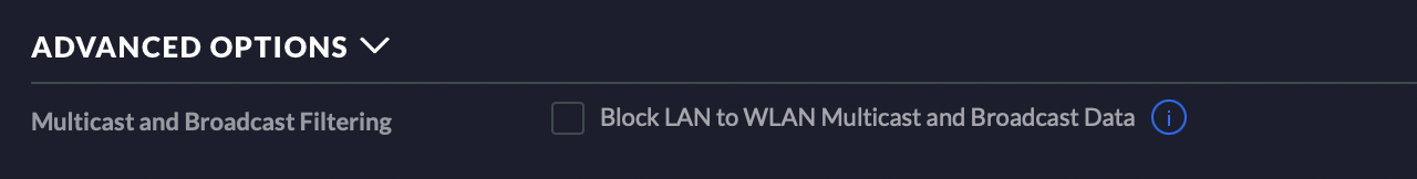

In your Unifi controller do you have the following:
That is in the controller settings, wireless networks, click on edit....to see the above setting.
Not sure if that would fix your issue, but worth a try.
