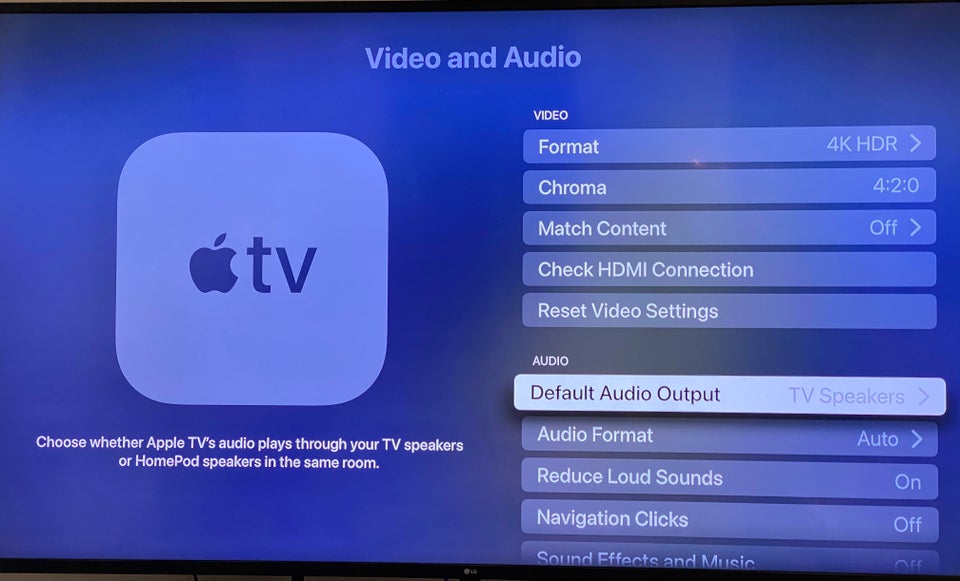

HomePods can now be set as default audio output through Apple TV I thought , however I have updated to tvOS 14.2 & HomePodOS 14.2 and dont see this option as per a TVOS 14.2 beta user.
anyone see it?

You've got the feature, right there, to select your HomePods as the default audio out. Are you saying you don't see your HomePods as an option when you select it? Are your Apple TV and HomePods on the same subnet?
the screenshot is not from my Apple TV its a photo I pulled from a article I read.
That’s correct - you select that option and the only thing listed is the tv speakers and not my stereo HomePods.
You can manually select them from the airplay menu as always but not set as default.
