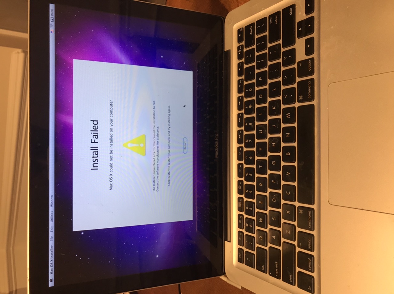

I tried using the snow leopard disc but I’ll include a photo of the error message displayed on the MBP screen.

I can't read the error message you posted. The phot is too small. Have you tried booting into Recovery Mode command + R and formatting the SSD from there?

I’ll include a photo in this reply, Huber quality.

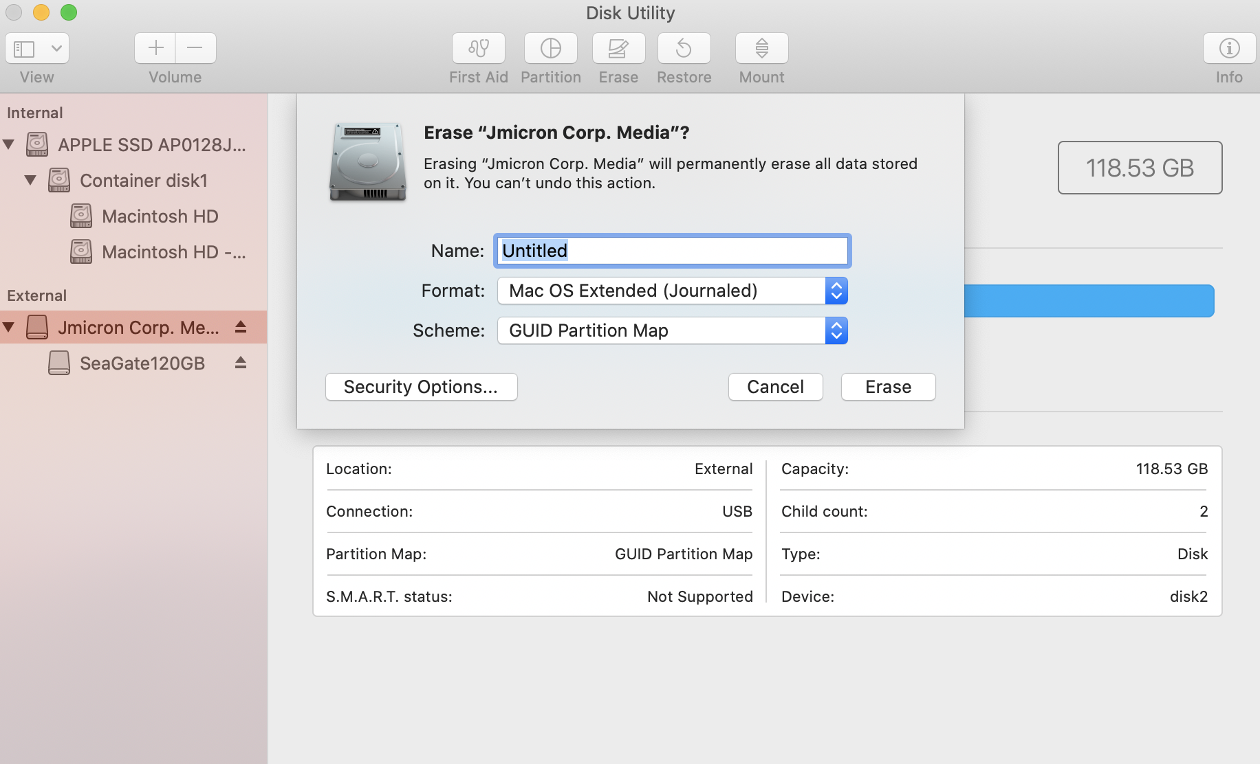

I do have a 2018 MBP I use daily that works fine and am using to connect the 2009 MBP SSD as an external in attempts to format it correctly. Am using GUID Partition option.

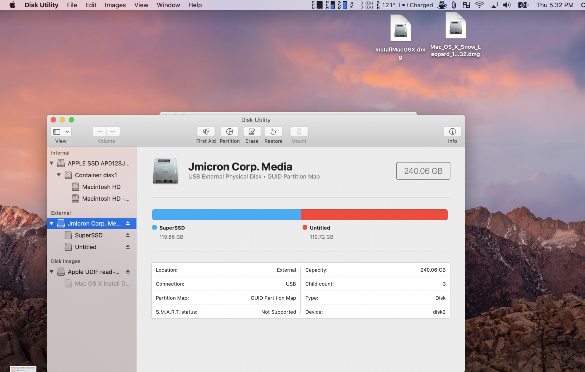

I have to admit and am embarrassed to do so that this part is confusing for me when I attempt to do so.
I’ve downloaded the file from the Apple site, El Capitan, and then I open the .dmg file and connect my 8GB USB flash drive to my 2017 MBP. Then I don’t really know what to do.
I tried to just drag and drop the .dmg file and the contents within into the usb flash drive with no overall success.
I also tried to use ‘restore’ In disk utility using the .dmg file as the source and copying it into the usb flash drive, all with disk utility but have yet to be successful. That’s even if that is the correct way to approach it.

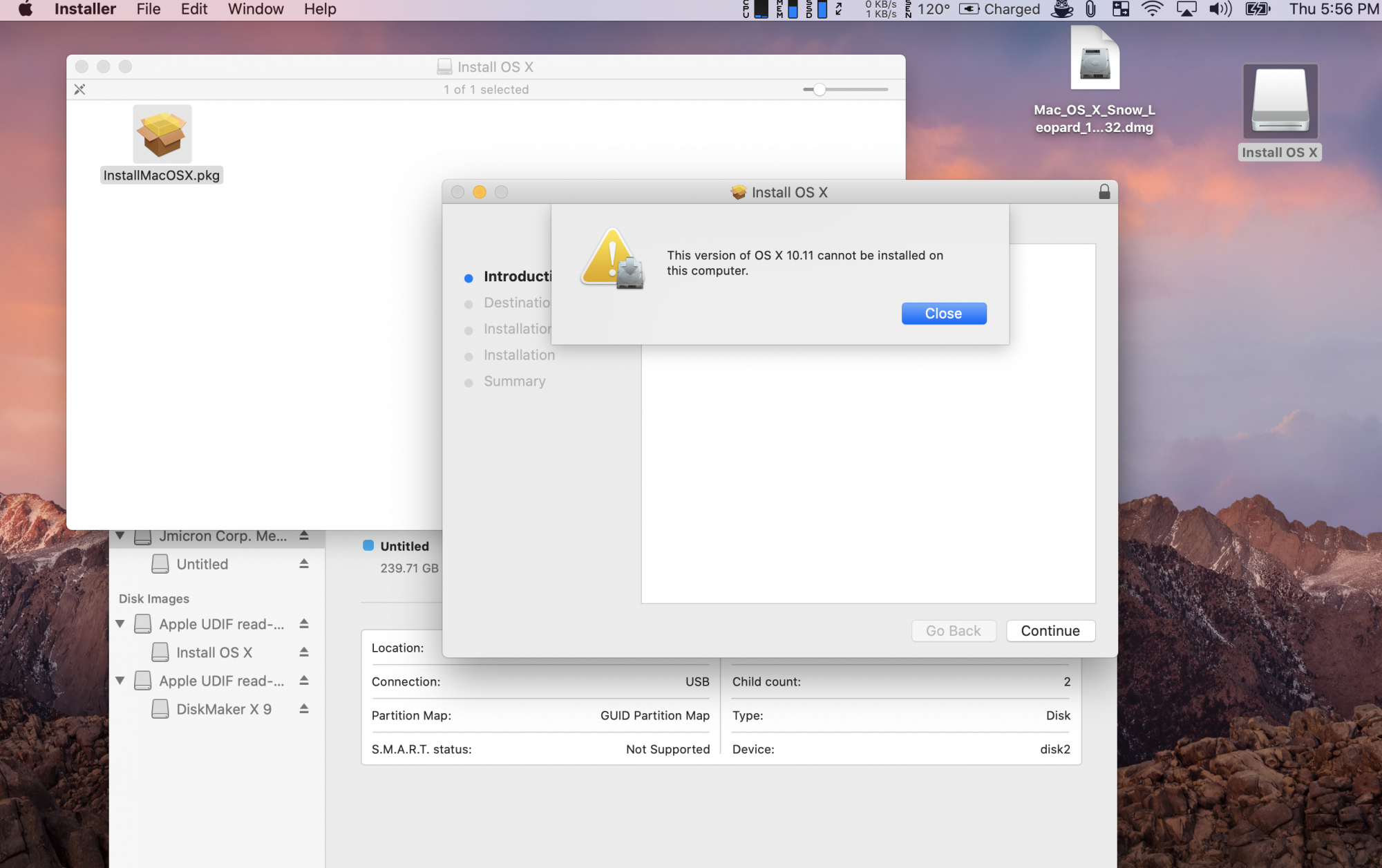

The DMG file opens up to a pkg file but upon opening it it says it can't be installed. I'll attach a photo. AM running Catalina on my 2017 MBP btw.
Also, I have 2 dmg files on my desktop at the moment. One with El Capitan and the other w/ Snow Leopard. Am focusing on the one w/ El Capitan.
I guess your computer is too new to let you run that installer. Use another computer, if you have access to one OR install a Virtual Machine using, perhaps, VMware Fusion in trial mode. That way you can run the installer and get the installer app to create the bootable installer. VMware Fusion can use the recovery partition to install macOS inside the Virtual Machine
In the menu above should be option Window or Utilities (I don't remember which) and an item called setup log or something similar, open it and look at some of the last lines, there should be a hint to why the install fails.
