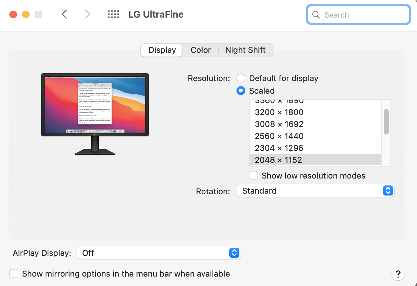

Flowrider's suggestion is a valid test, and should force your Mac to read the connected display (showing available resolutions), and you did not say if you did try that already.
If the KVM is an active/powered device, did you try recycling power to the KVM (while the ASUS is connected and powered on)?
