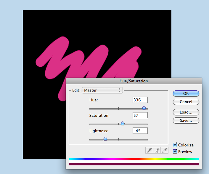

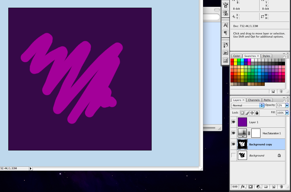

I would use invert (command-I) so you have white lines on a black background, then apply a Hue/Saturation layer over it, select the "Colorize" box and go from there until you have the color pink you like for the lines. Then create a new layer on top of everything, color it purple and select "Overlay" for the blending mode. Finally, drop the opacity of the main layer (with the drawing on it) down until the black background becomes the desired purple.
