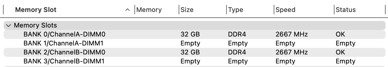

I have a 2019 27" i9 iMac running Ventura 12.6. I bought four used 32 GB Apple OEM RAM sticks from OWC. One stick in a pair was bad (iMac wouldn't boot), so I'm sending that pair back. The other pair works without obvious issue (thus far), but I ran two Rember cycles in Safe Boot, and got these errors on the first and second tests, respectively:
FAILURE! Data mismatch at local BUFA address 0x000000019a6e97b8, BUFB address 0x0000000879b9c7b8
BUFA Data: 0xffffffff80000000, BUFB Data: 0xffffffff80200000
FAILURE! Data mismatch at local BUFA address 0x000000060ffea7b8, BUFB address 0x0000000cbcbd47b8
BUFA Data: 0xd4d4d4d4d4f4d4d4, BUFB Data: 0xd4d4d4d4d4d4d4d4
Both tests also gave me the following error; I'm not sure of its significance—does this merely mean there's a risk of false negatives (missing a problem)? That wouldn't be an issue in this case, since a problem was detected. My concern is that it instead means there's a risk of false positives, i.e., that the above errors are not "real". Anyone understand Rember well enough to know whether it's the former or the latter?
Attempting memory lock... WARNING: Testing with unlocked memory may be slower and less reliable
ERROR: Memory lock failed - reason unknown.
Here's how they were configured—OWC recommends matching members of a pair be put into the same DIMM, so here they're both in DIMM0. Plus I found, from my own testing, that if you've got just one pair installed, they need to be in opposite channels to get full speed.
