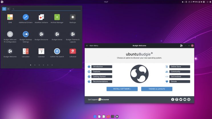

This is excellent for that device. Ubuntu BUDGIE
No joke, this distribution runs smooth on it.
