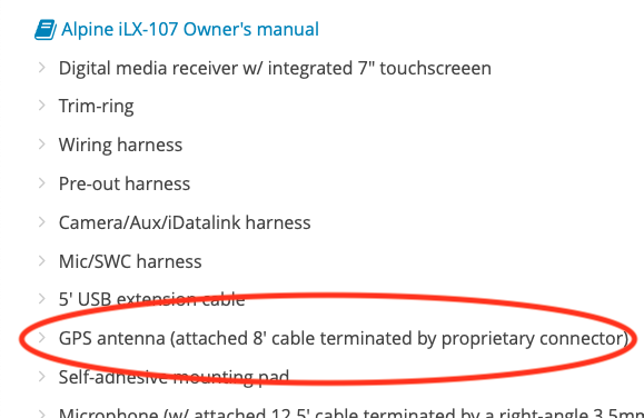

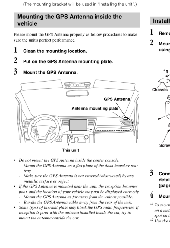

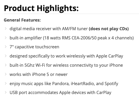

Overlay:
Please provide one reference that shows this is true. Because it's not.
It absolutely is true. When the GPS on the device was broken in earlier betas it worked in my car when plugged in. Even now that it works on-device the GPS accuracy, as measured by GPS diagnostics, increases greatly when plugged in. The car also feeds back low gas alerts, start, stop and moving information.

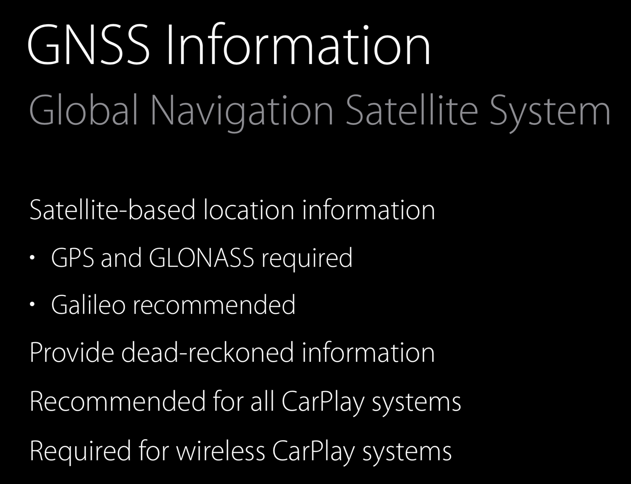

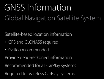

Better reference still. WWDC sessions for Car and Head Unit manufacturers.
Video
https://developer.apple.com/videos/play/wwdc2017/717/
Slidedeck
Presentation Slides (PDF)
In the section about what units need to provide, under Sensors
