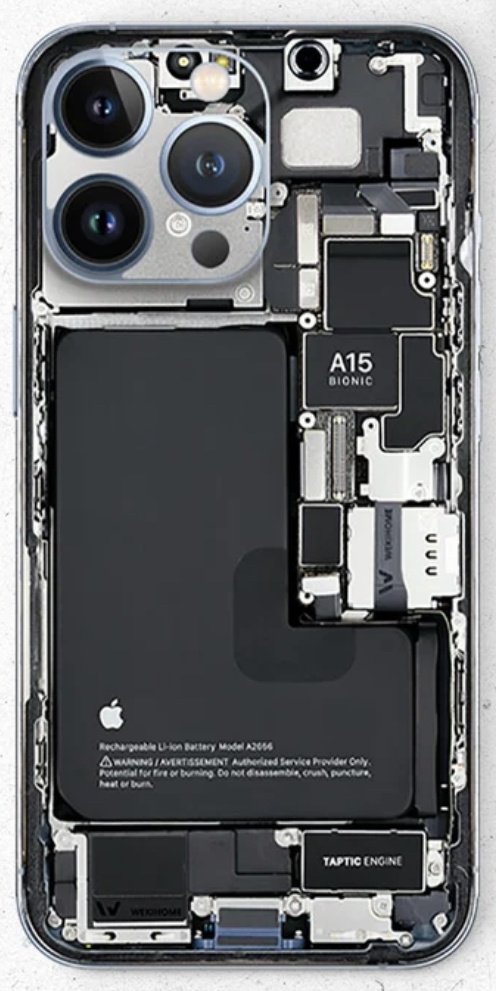

The smaller 13 Pro also uses 3,87V cells, look here (13 Pro battery l-shaped on the left side, 12 Pro battery on the right side).
