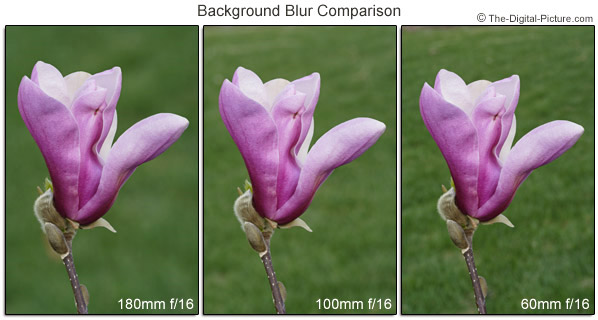

I was under the impression that you can achieve a different effect of 'blur' due to the perspective changes at a different subject to camera distance, even though your DOF is similar.
http://www.the-digital-picture.com/Reviews/Canon-EF-100mm-f-2.8-L-IS-USM-Macro-Lens-Review.aspx
that's because the aperture is larger with the longer lens. using a wider lens at a much wider f-stop will produce the same degree of blur, though of course the background will look different.

Thanks
EDIT: actually, looking back over the wik quotes (below) makes me think. Wik says, same aperture, same DoF. Except when using a crop sensor, the image must be magnified more when printing to the same print size, meaning smaller circle of confusion and smaller DoF. So you subtract 1 1/3 stops from from a crop sensor to get the same absolute aperture and at the same FoV, and thus the same DoF (if the two pictures were magnified the same amount in the final print with the full size sensor to a larger print). But if you print both to the same size, it would seem that you actually need to stop down (not open up) slightly from the minus 1 1/3 on the crop sensor to attain the same DoF at equal print size. E.g. you may need to open up only one stop rather than the commonly said 1 1/3 to 1.5 stops to compensate (I made up up the number 1 stop just to show the principle).
No one else is saying this so I'm sure I'm wrong. What am I missing?
According to wik here,“Adjusting the f-number to the camera format is equivalent to maintaining the same absolute aperture diameter; when set to the same absolute aperture diameters, both formats have the same DOF."
But, wik here explains, “Cropping an image and enlarging to the same size final image as an uncropped image taken under the same conditions is equivalent to using a smaller format; the cropped image requires greater enlargement and consequently has a smaller circle of confusion. The cropped image has less DOF than the uncropped image.”
anyways, don't confuse amount of blur with DoF. amount of blur depends only on aperture. DoF depends on focal length, f-stop, circle of confusion, and subject distance. the circle of conclusion is determined based on enlargement factor (and therefore sensor size and final viewing size), viewing distance, and a standard for visual acuity.
as I said before, the .1 stop difference comes from the difference in sensor size...
when using the equivalent FL on 1.6 and 35mm 1.5 stops apart, you get the same amount of blur.
if DoF did not depend on sensor size, there would also be a 1.5 stop difference in DoF between 1.6 and 35mm. however, it does.
the DoF is larger on 35mm stopped down 1.5 stops than on 1.6 because of the less enlargement required for the same viewing size.
for example:
10mm at f/2.8 at 5' on 1.6: 24.1' DoF
16mm at f/4.8 at 5' on 35mm: 28.7' DoF
f/4.8 is 1.5 stops narrower than f/2.8
16mm at f/4.5 at 5' on 35mm: 21.4' DoF. f/4.5 is 1.333 stops narrower than f/2.8.
21.4' is closer to 24.1' than 28.7', so we say 1 1/3 stop difference. the difference in amount of blur due to different aperture is negligible, so we ignore it.
I wrote this (below), then looked back over your last post, and it looks like you’re saying basically the same thing. The only thing I notice different is that it appears that 1 1/3 stops is enough to attain the same absolute aperture diameter at the different focal lengths required to get the same FOV on crop vs. full sized sensors.
But think I see how compensating with 1.5 stops might be more accurate to compensate for the magnification factor (I just leaned what is meant by this, BTW).
Anyway, I think I got most what I was missing.
By enlargement factor, you’re saying that, when the image from the cropped sensor and full sized sensor is enlarged to the same dimensions, your eye will have less tolerance for what is slightly out of focus because the what is out of focus in the image is magnified more (the “circle of confusion” will appear [EDIT] smaller). This effectively narrows the DOF.
I wonder if this DOF calculator takes this into account when it gives me these numbers?:
10 divided by 2.8 = 3.57 (aperture), with a DOF at 5’ of 24.1
16 divided by 4.44 (I added 1.333 stops here) = 3.6 (aperture), with a DOF at 5’ of 21.4 (rounded to f/4.5 for the calculator).
If I add 1.5 stops and round to f/4.8, I get a DOF of 28.7 ft (full sized sensor, 16mm focal length, 5’ from focal plane).
So maybe somewhere between these two numbers is where you get the 1.5 rather than 1 1/3 stops?
The aperture is the same when stopping down 1 1/3 on a crop sensor, but perhaps the extra 0.15 stops takes into account the magnification factor? It seems like I should think open up 1.5 stops to get equivalent out of focus blur on a crop sensor, which I think is what you're saying.
