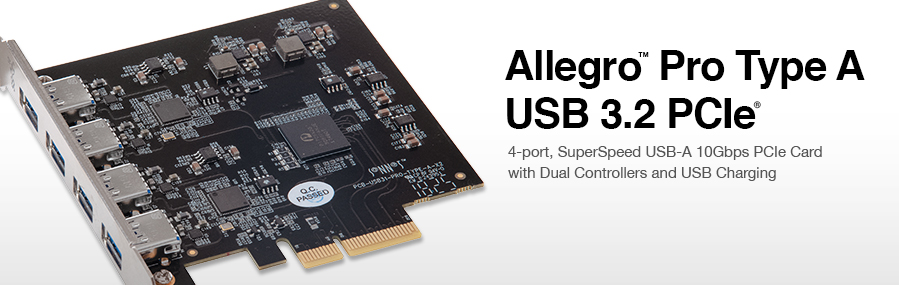

Sonnet has a great two controller chip , four USB Type A port 10 Gbps PCIe card for your MP7,1 .
Allegro Pro Type-A USB 3.2 PCIe .
I've used these in cMPs with nice results .
If you connect two different high performance drives concurrently , make certain they each use a port with a dedicated controller for best results .
far left and near left ports utilize one controller , near right and far right ports utilize the other controller .
Thanks! I have just ordered it.

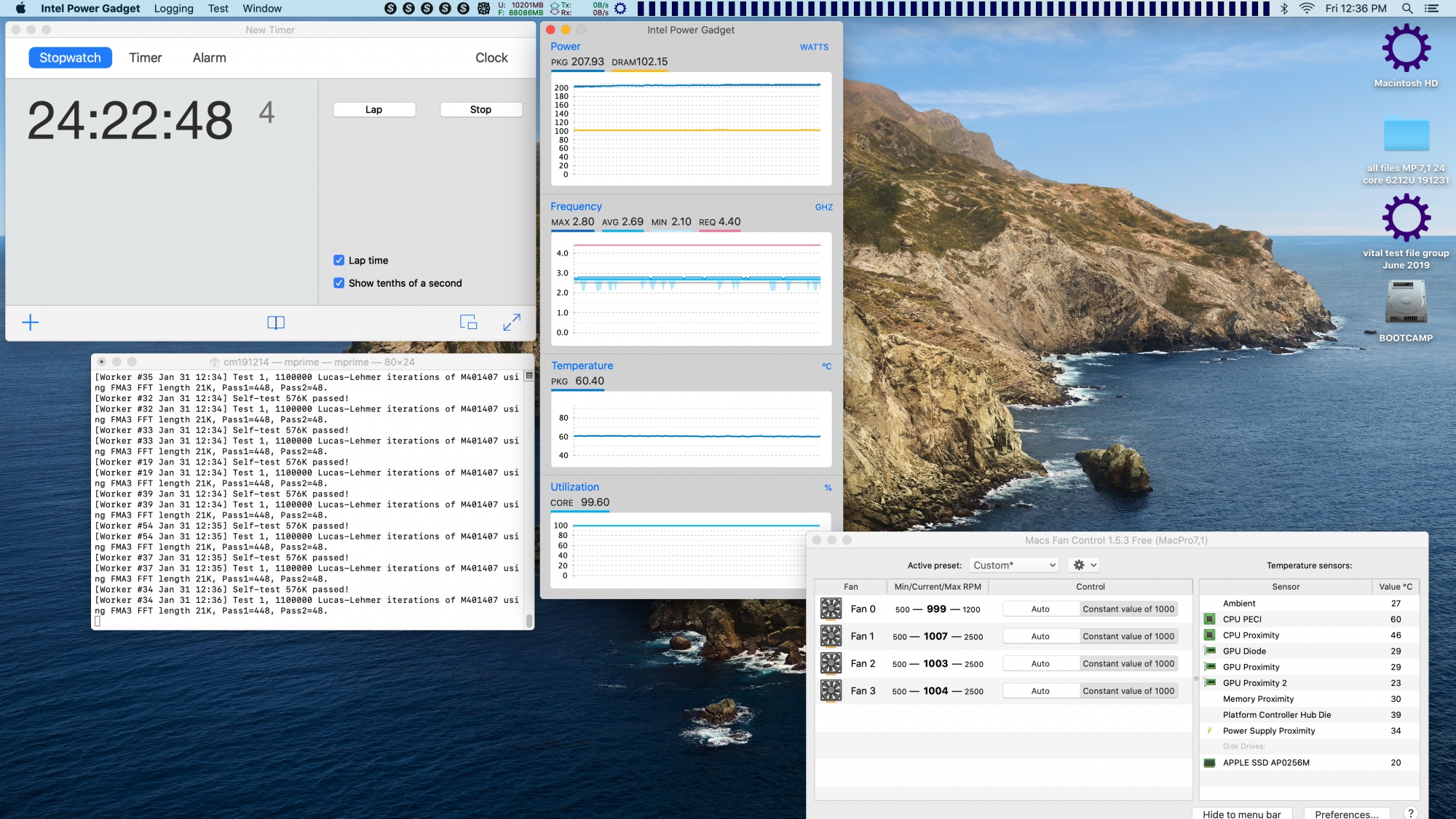

Nothing wrong with performing a burn in of your Mac right after you received it .
If anything , if the system fans are going to fail it'll be within the first week of heavy use .
I upgraded the processor of my MP7,1 ( from the factory 8 Core to aftermarket 28 Core ) and she already passed a stress test for 100 hours straight that pushed all the threads of the CPU at 100 percent usage . Cool as a cucumber with all the fans at 1000 RPM. Very quiet , too .
The test was the GIMPS prime test in macOS .
"Very quite" I like this a lot :cool: 👍. I often mix at very low volumes ...I am already dreaming.
On one of the threads here I actually measured the sound pressure of the MP7,1 while she was doing her stuff , if you're into decibels .
OK, clear. I have read it.
My studio SPL meter also does not go very deep. Anyhow, once she is here I will hear her whispering :) . Note: Recently the ear doctor said that my hearing is very good. We will see
