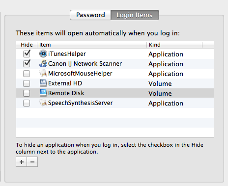

What about just adding the disk to the log in items?
The "Remote Disk" is connected to the Airport Extreme.
Yes, that works, but as it mentions in the link I posted, a Finder window opens for each mount, which is doubly annoying because there is quite a delay before it happens so you're in the middle of typing an e-mail when 3 Finder windows pop-up on top.

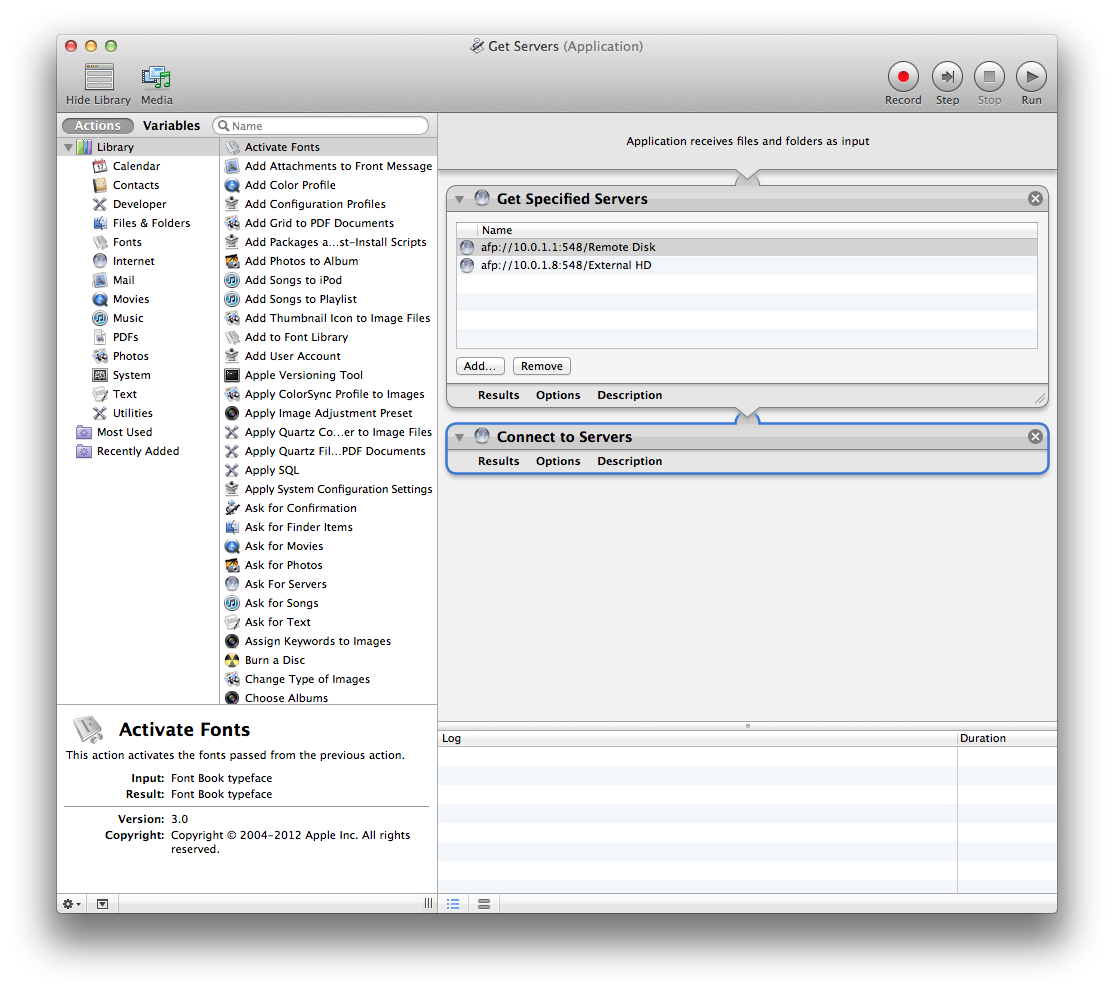

You could also use Automator to build an application that mounts the requested server volumes.
I just created one to mount two server volumes on my network, and using Automator doesn't open finder windows when it runs at startup.
Thanks, that works but since it's in Login Items it only works when I log in so the volumes don't remount when waking from sleep. Is there anyway to make this (or another) script run when on wake from sleep?
