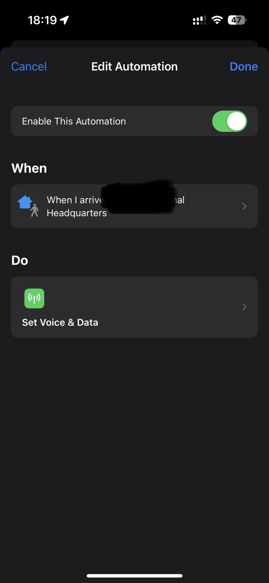

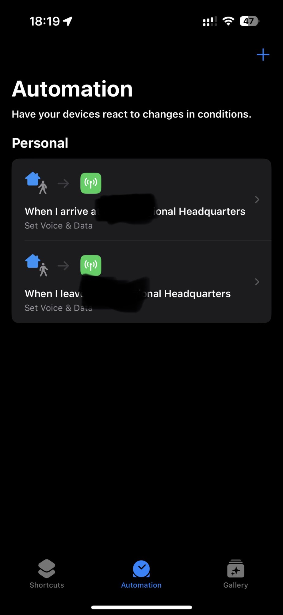

Found a solution with Automation function, yet to test out but I think it should work.
Automation 1 when I arrive at office to move to service provider A
Then when I move out Automation 2 to move it to B. Just have to check if default voice line it will reset. If not this would be perfect.

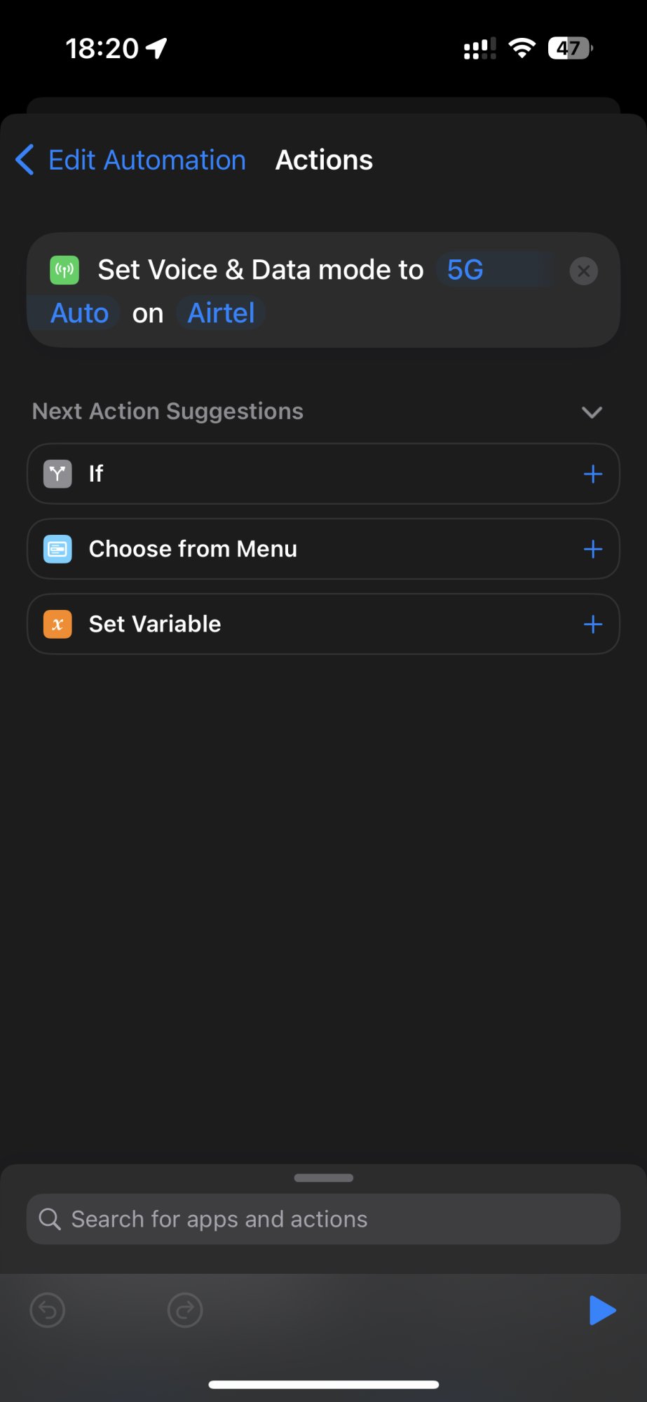

And EPIC fail, does not switch the data plans :) I guess it just reconfirms within the data plan it is on 5G Auto settings 😂
Could have been a very useful feature but not!
