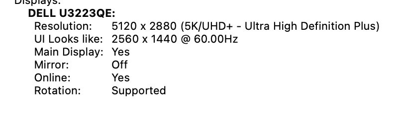

Thanks guys, so this is probably a dumb question. So I used the usb c to usb c cable included. Idk if I plugged it into the right port, there's multiple usb c ports. I find I need to scale the ui down to "looks like 1920x1080 because it's way too small on default. I'm aware of the scaling issue with non mac monitors but this is realllly small.
So my question is did I plug it in the wrong port? Or is that even possible to plug it in another port and get a picture but just not the "right picture?"
When I check in system settings it's telling me Resolution 5120x2880 5k and ui looks like 2560x1440? How's that possible if it's a 4k monitor how is it on 5120x2880??

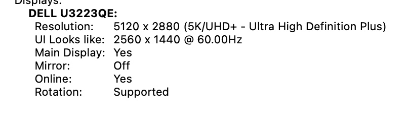

That's because these monitors don't scale well on Mac's. I have the 27" version of that monitor and this is what I see.
Resolution: 5120 x 2880 (5K/UHD+ - Ultra High Definition Plus)
UI Looks like: 2560 x 1440 @ 60.00Hz
Unless we have a true 5k Monitor like the MAC Studio Display or the LG UltraFine 5k we will never be able to take full advantage of the resolution.
There are others here who know more of the technical jargon than I do on this but basically that's what it boils down to.

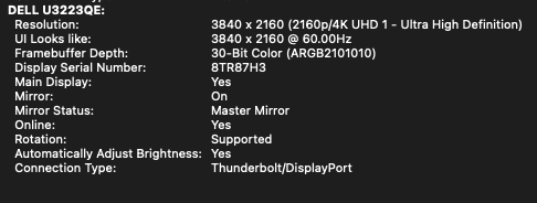

I’ve been using the Dell Ultrasharp 3223QE with my 2017 MBP while I wait for my Mac Studio to ship.
So far I’ve had great experience with true 4k res, including UI, no scaling needed.
Sorry if this sounds dumb, but why are you guys pushing 5k into a 4k monitor?
Am I missing something?
