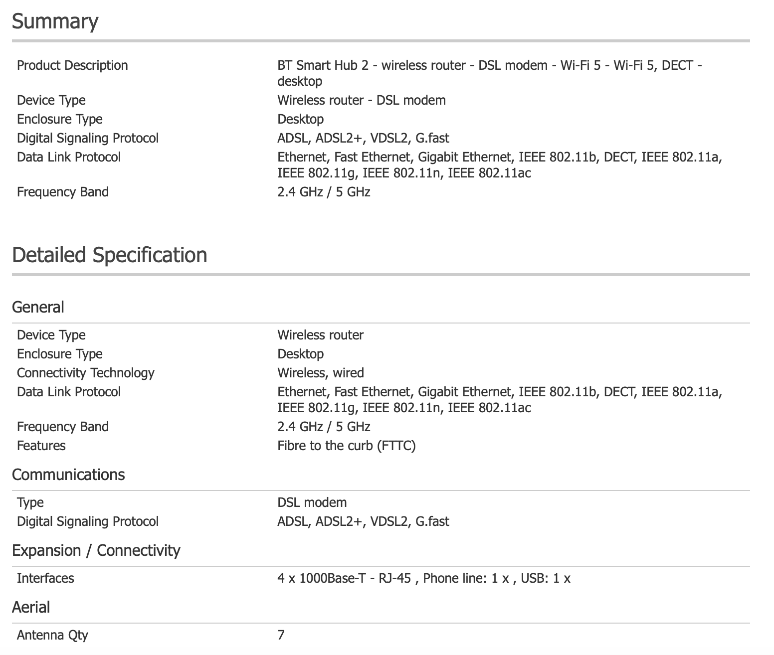

3. How fast will it be over the WIFI, I believe I have gigabit ethernet on my router which is a BT Smart hub 2 ( See spec below) will this be fast enough to edit video from?
4. can I access all the above if I'm away from my home?
5. what models do you all recommend. As a family we have 5TB of Data
6. How safe are they from hacking etc - just as safe as our Macs?
here is the spec of the router - thanks for any help/advice. ps reason for doing so is to save cash on all our iCloud storage plans plus the idea of being in control of our data.
I believe wifi 5 is the same as 802.11ac wifi? Using my macs at home on a local network, last time I tested (years ago) I could get speeds of 50-60MBytes/sec using my 2013 MacBook Air - one of the first generation(s) of Macs to support that protocol. Using wired gigabit ethernet with a 2012 Mini for the same thing on my LAN, it was in the 80-100MBytes/sec range. Some of the bottleneck was no doubt the speed of the local shared disk (on a 2014 Mini). Anyway, I don't use iCloud but suspect those would all be comparable to - probably better than - the speed you get now.
