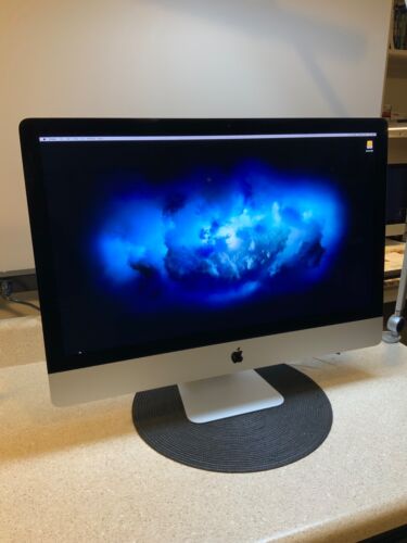

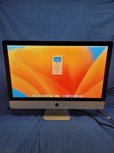

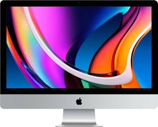

Huh, I can't either. Although I did find some decent deals on 27", although I know you don't want that, but you might take a look:
de anza
macrumors newbie
Apr 9, 2023
12
2
Thanks, I will probably buy one of these.
