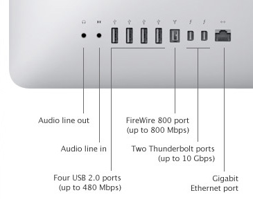

However: The monitor also has DisplayPort. Why don’t you use that?
I assume that is the TB2 port? I honestly thought I could just use an adapter for the TB2 port, and it would automatically be using Displayport.
The iMac has Thunderbolt 1. You can connect a DisplayPort monitor directly because the Thunderbolt controller operates in passthrough mode in this case. Additionally, it can output single-link DVI/HDMI signals if using a passive adapter like yours (this is called dual-mode DisplayPort) but that is subject to a 165 MHz pixel clock limit due to the GPU.
