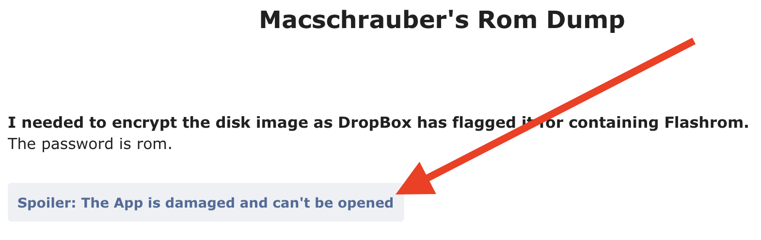

WAAATT!!! This is so cool!! Your images are so clear. Thank you very much for the detailed info with no confusion.
The #5 RomDump is no good, it can't be opened. Is there another one?
Did you try the solution in that post?
