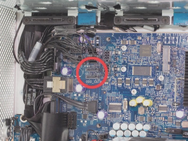

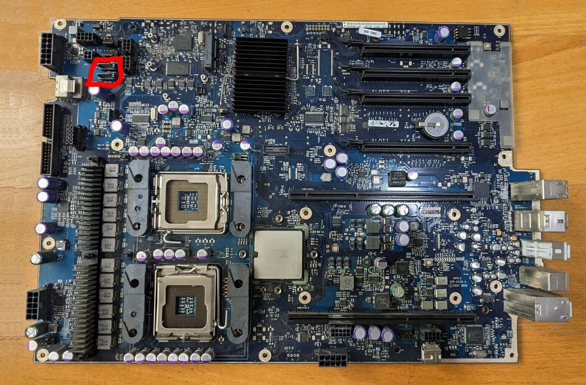

I'm glad I posted here, I got some advice previously that said there were 2 spare SATA ports on the 3,1 motherboard There's a thread about it on the OCLP discord. See image:
They are the same ones I highlighted earlier. AFAIK, they only supply power handle data and you also need to handle data supply power.

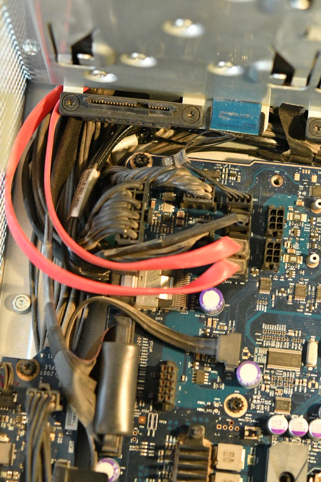

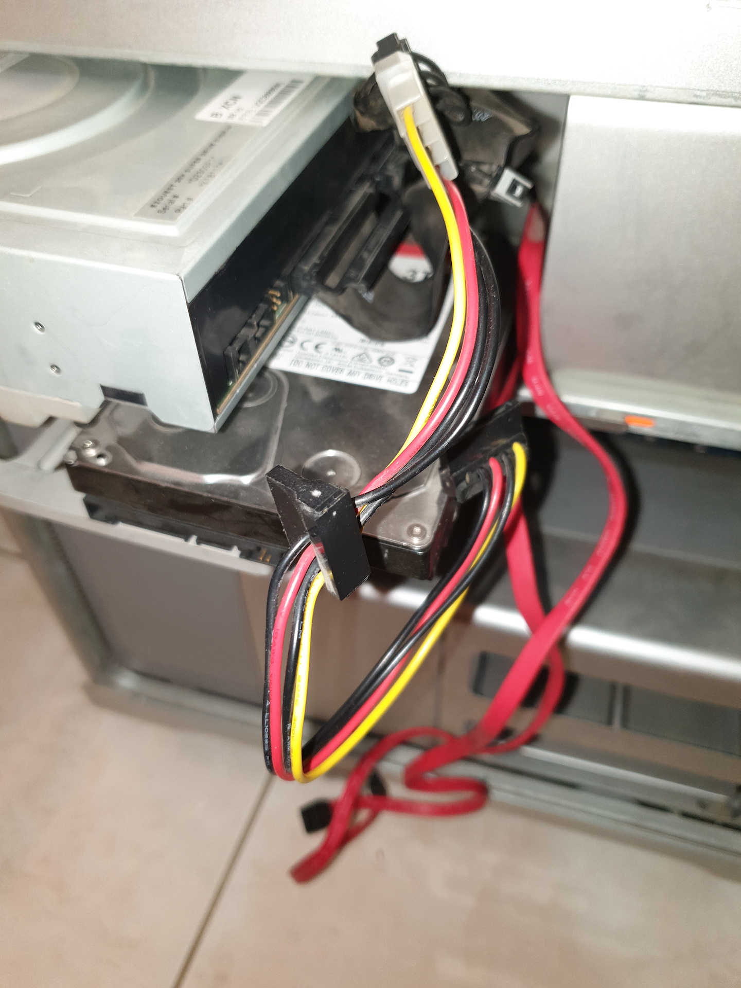

Got home and checked.
It is a Molex to SATA (x2) and the two red cables (running down the back) to the SATA ports:

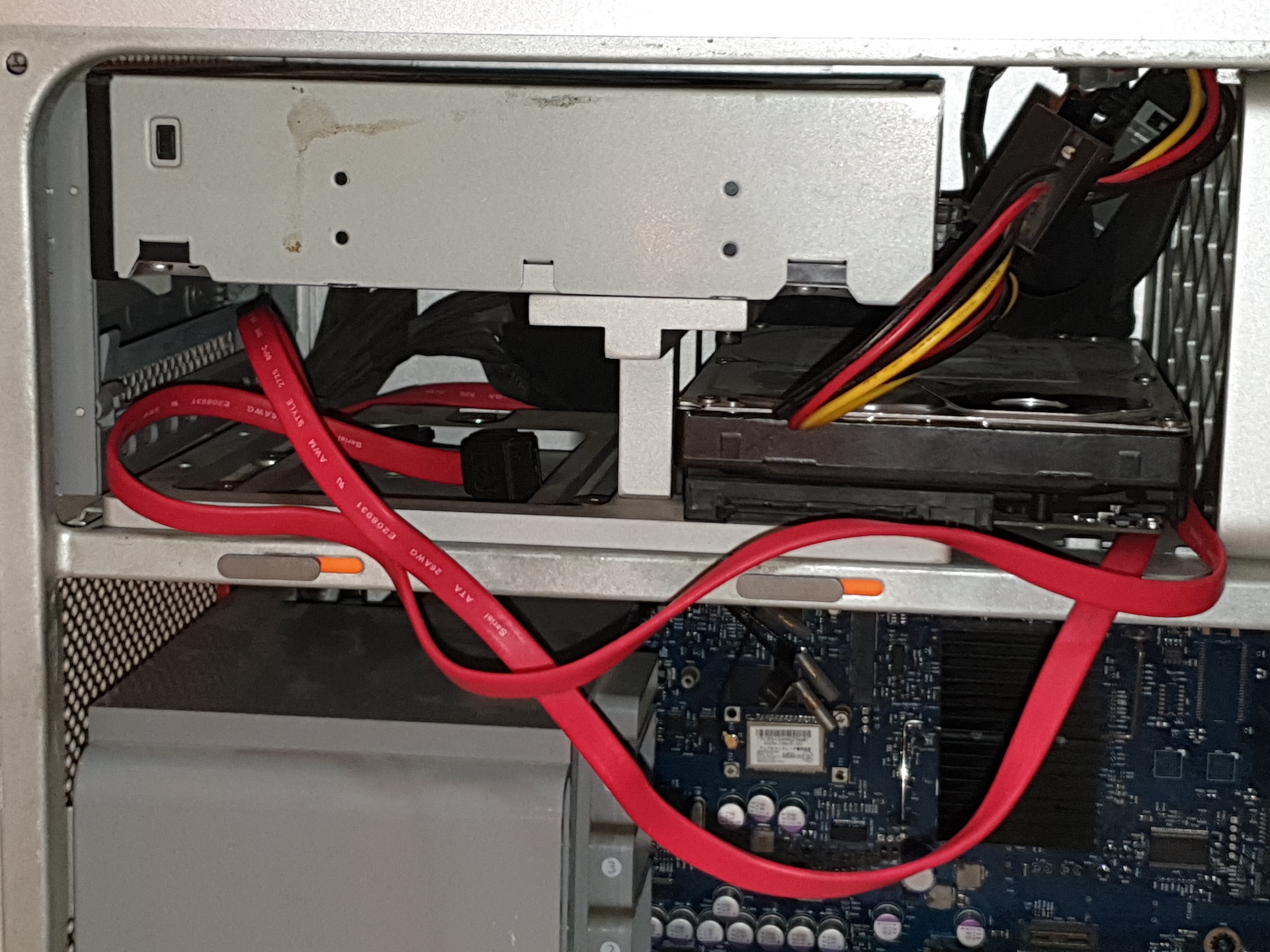

Got one disk there ATM for backup but used to have an SSD in the other position as well.
