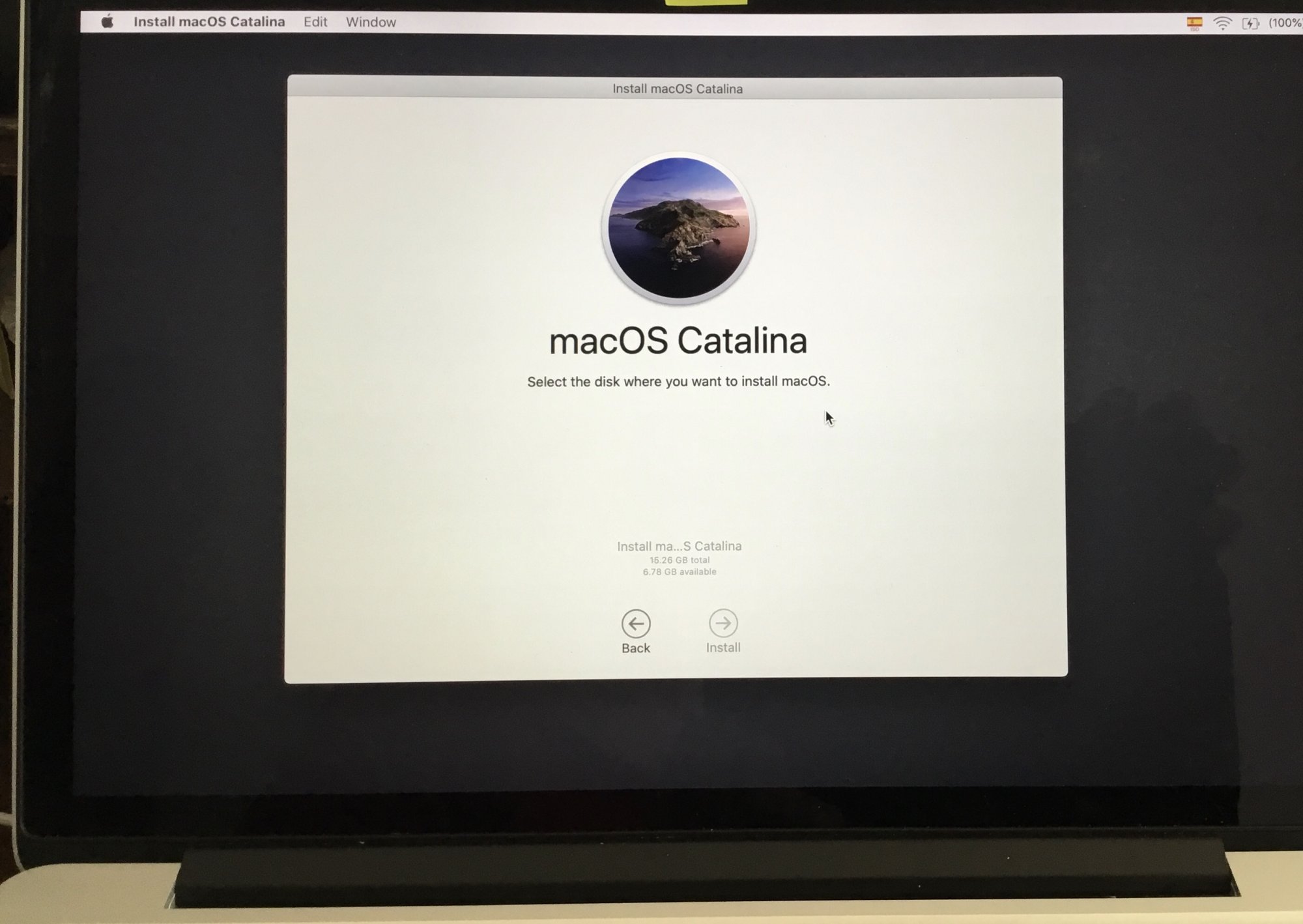

Your install hasn't started yet because the installer doesn't see an installation destination disk. You may need to unlock the disk in Disk Utility, or if it's a new disk, you need to format it first.
How do I do this? I'm installing from an USB following the instructions of this post. The USB was formatted as Mac OS Jornaled and it has Catalina. I hit back and now I see this screen:

Yes, it would have to be unlocked, which you do by clicking on Disk Utility in that menu. If you're just upgrading the existing operating system, the process is a lot simpler by just running the Catalina installer from the disk rather than from the USB drive, and the net result is exactly the same.

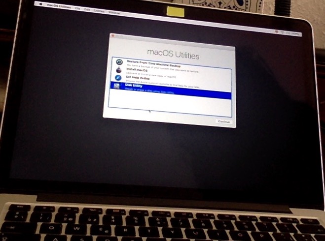

Yes. I can't erase my HD via Disk Utility in normal login. The minus sign is in off even if my admin user is unlocked. The drive is now unencrypted.
Make sure that Disk Utility is set to "Show all devices" in the View menu. Click on the disk itself– it'll be called something like Apple SSD AP1024 or similar. Choose erase.

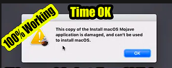

OMG what an ordeal. Yesterday morning I downloaded via the Apple Store the latest Catalina version (10.15.7 I think, published September 2020). The intention was to get rid of Big Sur, perform a clean install (my data was backed up) via an USB drive. I followed all the instructions and ended up with no operating system. Maybe somebody will read this and avoid all the things that failed. This is the bunch of stuff I learned yesterday and you shouldn't know or go through as the user of the most expensive OS in the world: all versions of previous MacOS operating systems have a security certificates that expire at a certain point. If you try and install via USB Catalina and previous OS, you will probably receive an error message during installation, something like this:

(Image not mine, just to show the error message)
Saint Internet says this is solved by changing the date via Terminal to a date before the certificate expires. I tried 20 combinations of dates, while shutting off wifi so the computer wouldn't detect the actual date. This took me like 6 hours. But before that I had a bizarre issue while wiping the main HD. My Mac wouldn't allow me to hit the - sign, erase or partition. I have no idea how I managed many times until I deleted the drive, then obviously got the folder image that warns you there's no system. I didn't panic as I thought that was required for the clean installation of Catalina, which never happened because of the certificate thing.
