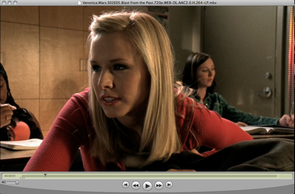

Part1: Get MKV file and open with QuickTime 7 Pro.
Part2: Wait for it to buffer

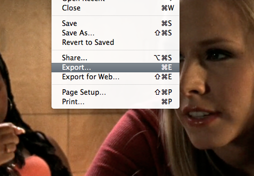

Part3: Export

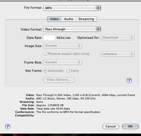

Part4: Press dropdown box and select Movie to MPEG4 then press options.
Part5: Make sure file format is MP4 and not MP4 ISMA and make sure Video format is "Pass Through"

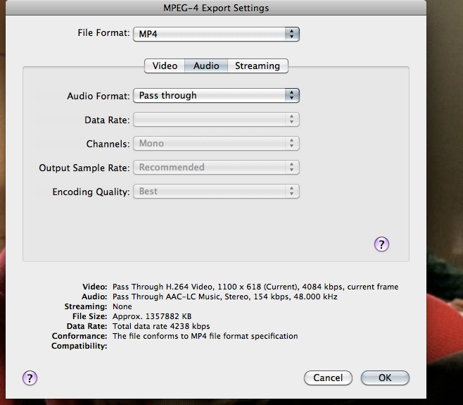

Part6: Make sure Audio is pass through too
Part 7: Press ok then save

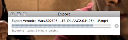

Part 8: Export takes a minute then drag MP4 into iTunes and Sync to iOS device or AppleTV
