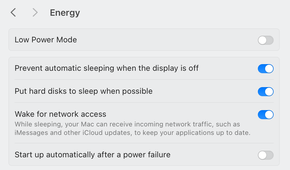

Just go to Setting -> Energy and make sure to put the disks to sleep when possible.

Alright, I've figured this out. It was pretty simple.
Connecting with ssh remotely will keep your mac awake. Once you're in set a caffeine command or keep the ssh connection active.
Interestingly if I start a caffeine process for like 120 seconds the mac stays up indefinitely.
So if that happens to you too and you want the mac to sleep simply run 'sudo pmset sleepnow' and then close the ssh connection.
