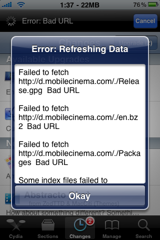

Tired of seeing this:
It's most likely happening due to a repo that is either damaged or no longer working. Here is a very easy fix to get rid of those pop ups.

1.Once connected go to the main directory and then navigate in the SSH program to /etc/apt/sources.list.d/ Look for Cydia.list and open it with a text editing program on your computer.
2.Look for the sources that are giving you problems (ex: deb http:d.mobilecinema.com/ ) on the device and simply delete them from the list.
3.Now save that list and copy it back into your device via SSH.
4.Over write the previous Cydia.list file.
5.Now re-open cydia and refresh your sources and the Error repo's should be gone.
I hope this worked for you. If you need any help reply. :D

Use Mobile Terminal (from Cydia) and install Cyfix (non GUI version) from Cydia..
It is no doubt the BEST way to get rid of expired non existent repos.
(Assuming you already have Cyfix from Cydia installed)
  1. Open Mobile Terminal
  2. Type in "su" hit enter
  3. Type in your password or "alpine" if you haven't changed it yet.
  4. Type in "cyfix"
  5. Then type in your problematic URL.
Respring and viola.
It EXTERMINATES it COMPLETELY. It will NEVER return (unlike the iFile trick)

Cyfix doesn't get loaded onto your PC.
You install it on your iPhone thru Cydia.
Without MobileTerminal I can't help you on this method.
Or go into iFile, navigate to /etc/apt/sources.list.d -> cydia.list and delete any sources that are returning errors. Save and you are done.
Much easier IMO.

Thank you soooo much.....
Every time I opened up Cydia and it was refreshing it would always come up with an error cause because I tried adding a repo called beyouriphone. Ugh dont do it people. So I used iFile and went into where you said and deleted two repos (the same source) and now woo hoo no errors!
-Dave
