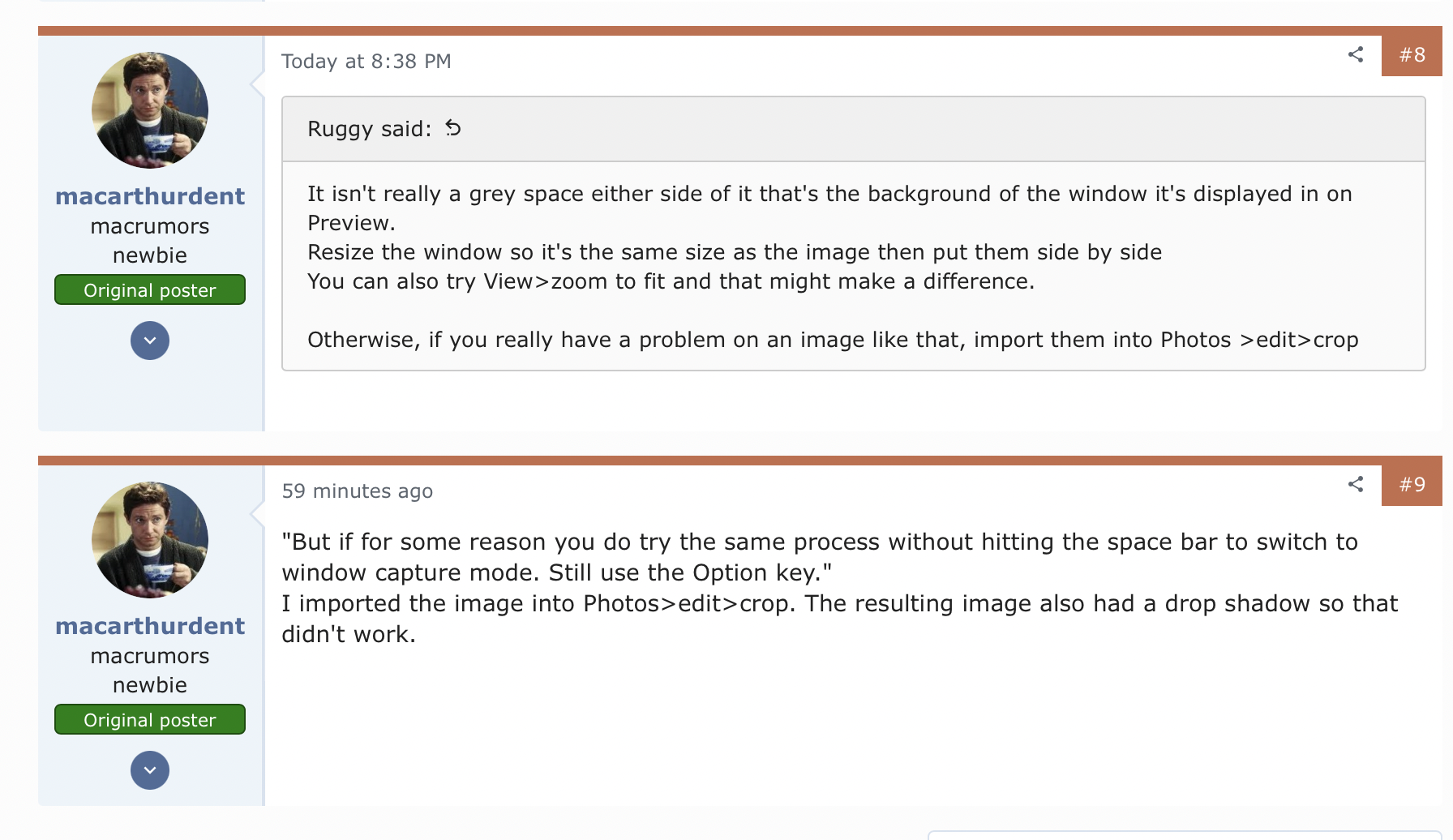

It isn't really a grey space either side of it that's the background of the window it's displayed in on Preview.
Resize the window so it's the same size as the image then put them side by side
You can also try View>zoom to fit and that might make a difference.
Otherwise, if you really have a problem on an image like that, import them into Photos >edit>crop
"But if for some reason you do try the same process without hitting the space bar to switch to window capture mode. Still use the Option key."
I imported the image into Photos>edit>crop. The resulting image also had a drop shadow so that didn't work.
