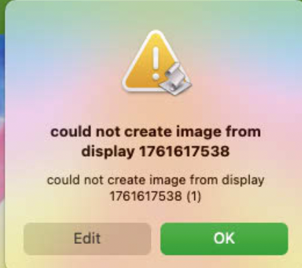

I want to take a screenshot of the MM desktop (MM 2018 running OS13) at intervals and have it sent via email. So, I have written a script that does this. Purpose is to see what is going on when the MM is unattended. The MM is used as a server so runs 24/7.
The script work fine if I am logged in via another computer. It does not work if I am not logged in. So, I am pretty sure it is not the script (see pic of error below).
My suspicion is that somehow the MM notices that nobody is there (so to speak) and as such the screenshot does not work.

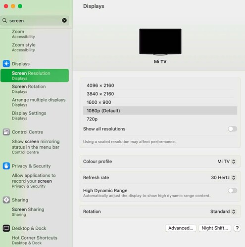

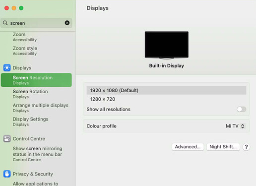

The MM has a dongle (Brand MI TV) in the screen port. I needed to do this since screen sharing (via remote management) does not work properly without a monitor connected. The dongle does the job for that perfectly (see also the pics of error below of the control panel).
The Dongle is present during the booting process, so one would think the Mac thinks there is a screen. However, does not seem to be recognised as a screen if I want to make a screenshot.
Does anybody have an idea as to how to trick the system in to thinking there is somebody watching on a screen and so make the picture work? Again, logged in it works, not logged in it does not.
Here the pics of the control panel after I connect or disconnect the dongle.
Here the pic for the notification I get when the script runs, and it does not send a screenshot.

When no user is logged in then there is nothing to screenshot except for the login screen.
There is a user logged in.
What is preventing you from doing a normal graphical login on the machine to keep the user session open at all times?
That is what I do. I log in romeotely and I log out again over screensharing. But the user on the MM is still logged in.

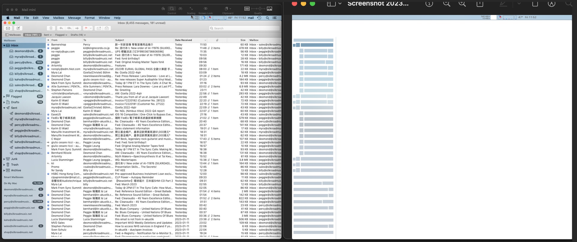

I just remembered some screenshot related experience: on remote-accessing an old macOS like Mojave or older, somehow initialising a screen capture remotely will give a blank image (same as what you try to do but manually). I figured this is probably graphics driver related since this happened with a Mac mini 2012 running headless. At that time my solution was simple, I then initiated the screenshot capturing on the ARD client-side, because WYSIWYG so this way it worked.
So while it is not an ideal solution but I bet you could in theory setup a 2-step screen capturing routine, where the actual capturing happens on a remote machine instead of the host mini. You could probably even do this with a VM or something and it can have a constantly connected VNC session to the mini within the same LAN so there's minimal network issue.

To clear things a little:
The scenario I brought up with remote screenshot not working correctly was only an anecdotal example, it only happens with this machine and this instance of macOS which I thought was relevant to OP's issue due to how it behaves.
I am attaching two screens to illustrate what happened: the remote machine is a headless mini 2012 running Mojave with Mail.app opened. The client machine used to access is a Mac Studio running latest Monterey with Apple Remote Desktop app also latest. The above screenshots: left is via client-side ARD, and right is captured within the server-side Mojave. As you can see all black text are gone, including GUI elements within Mail.app and the top menu bar. Even iStat Menus have some elements missing. To me this is clearly a graphics driver issue going on. The remote Mojave instance is running headless without a real display connection and a dongle, so even though the VNC is active and we clearly are getting a screen drawn and is working correctly via the ARD client, but, the screen capturing utility within that server-side macOS seems to rely on different ways to get the final rendered image.
The whole point I was trying to make in regards to OP's situation was that, there can be a number of reasons keeping a remote screenshot to work correctly, and with VNC somehow a solution is to then skip the server machine, instead use the client machine to do that instead.
I think screenshots just sometimes don't work like this, but not always, it is unknown to me what dictates this behaviour. I have an almost exact same model of another mini 2012 (with just a lower clocked i7 but everything the same), it runs Catalina and its screen shot capturing does not behave like this, it works perfectly.

FYI, I added the dongle because if it is not attached I get strange resolutions if I log in remotely. Do you not? So somehow the dongle does something to the graphic interface. See also the pictures above of how the control panel responds.
Yes different software definitely uses different methods to get the image, thus one may have problems while the other not.
Then depending on certain makes of Macs, with or without a display or even a dummy one, you get close to no option to resolution or it sticks to a certain default. In my experience with headless minis, it seems it is always 1280x1024, unless you go very far back with much older Mac OS then I believe it was 1024x768 instead. With the presence of a dongle, or an attached display even if it is off, the OS gets to set the resolution to the last time it used the display, until a reboot I think. For instance I have a media mini that has its HDMI permanently connected to an AV receiver which is never turned on until we need video. So whenever I remote into it to just play audio for instance, I always still get 1920x1080 full HD which is what that HDMI connection is supposed to be at when active. In fact I can unplug the HDMI and the resolution won't change, until the machine reboots that is.
Chancha thanks, an intersting puzzle is it not. My resolution etc. changes as soon as I pull the dongle or plug it in.
