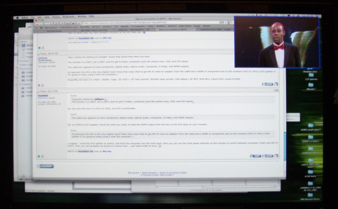

Then I suggest you ALSO run a RCA-to-RCA cable from the box composite video output (yellow) to the monitor's composite video input and then you can probably do picture-in-picture too! ...and watch both at once. :) It will only be using the standard definition picture from the cable box, but the video image is reduced anyway (not HD size) and it's a very useful feature!

Well, I can understand that, but STILL run the composite video link (or S-video link) between the cable box and monitor, so you get the picture-in-picture facility as well. (You won't get that facility at all, with a splitter, of course!) Good luck. :)
