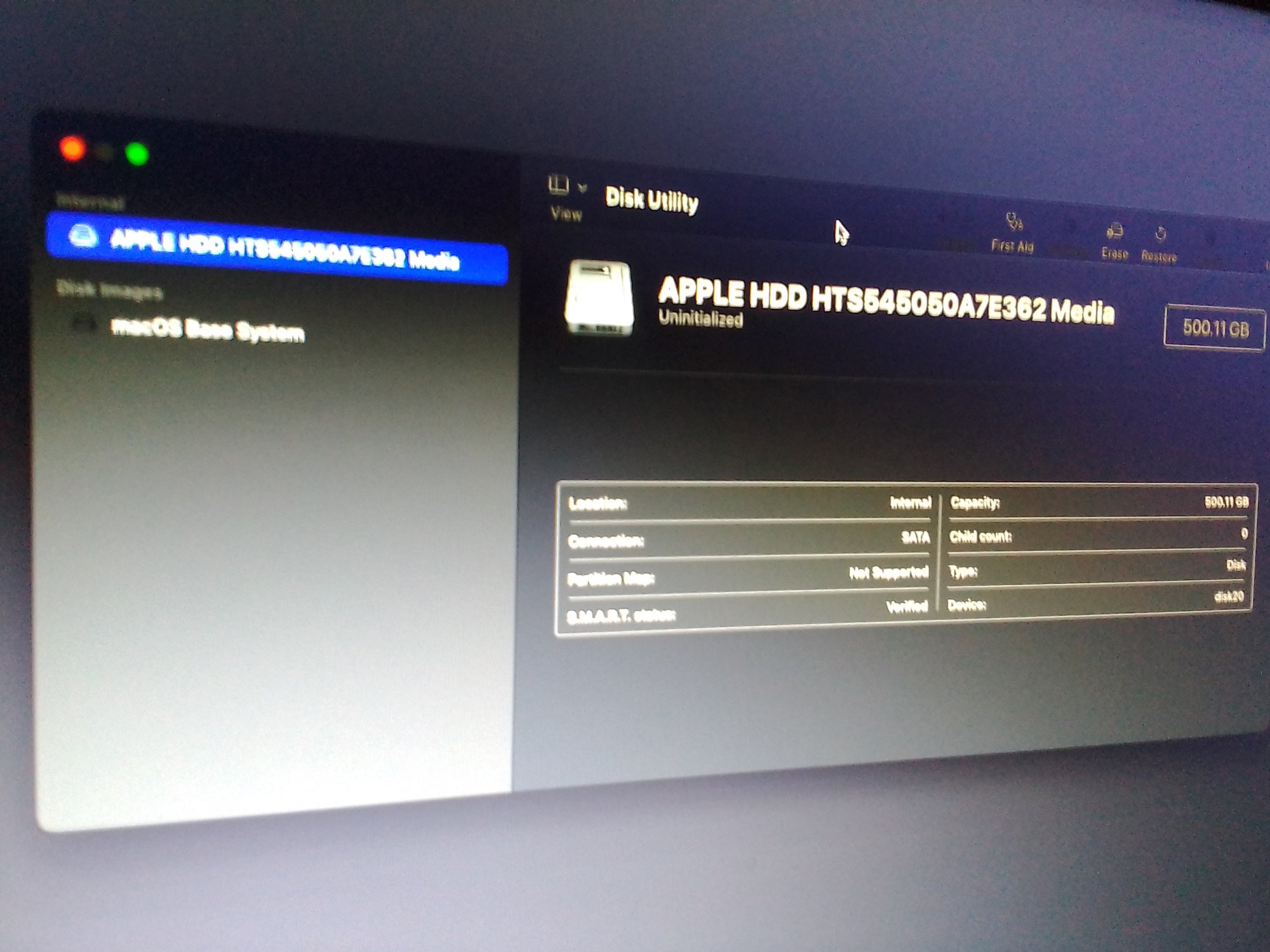

OK, let's pause for a moment and assess.
It sounds like you were successful at getting it booted to internet recovery.
But, when you tried to use disk utility, the internal drive "isn't there".
Try booting to internet recovery again, please.
Repeat the steps (yes I realize you did all this once already).
Get booted, get to disk utility.
After choosing "show all devices" in the view menu... what exactly does the top line in the list on the left say?
Write it down or take a picture and post it here.
Please find attached the picture
I tried to take a screenshot without success, sorry for the quality
As always, "show all devices" is selected.
So i rebooted into internet recovery mode, the disk now appears again in terminal, but doesn't in the gui app.
I used the eraseDisk command, with HPFS+, but I'm again stuck on "Waiting for partitions to activate" (50%)
I will try other file systems to see if that helps

attached is a screenshot, of when the disk appears...
I did run first aid, but it said something like "Done" after 3 seconds and that's it
You just need to click erase and that should allow it to be used. However, if it doesn’t always appear then you can be sure it’s failing.
If erase doesn't work, you can use partition too.
But a system of that era? Yeah, it's likely the drive is failing. Cheap and easy to replace - ifixit.com has instructions.
  • Love
Reactions: Username5281
I tried to click Erase using GPT + APFS: got stuck "Waiting for partitions to activate"
same with GPT and HFS+.
I think Partition is greyed as you could see in the photo
Sorry again for the quality

OP:
I'm looking at the image in reply 17 above.
This is what one should see when you select "show all devices" from the view menu.
The topmost item IS the internal hard drive.
In the pic it's already selected.
The next thing you should do is click the erase button.
Erase to APFS, GUID partition format.
If that doesn't work, try erasing to "Mac OS extended, journaling enabled, GUID partition format".
If THAT doesn't work, I'd try erasing it to ExFAT.
IF it erases to ExFat, THEN try to erase it to APFS again.
If you can't get it erased at all, then I'd say the drive is toast.
Don't waste any more time with it.
Either replace the drive, or put the Mini in the closet or sell it.
