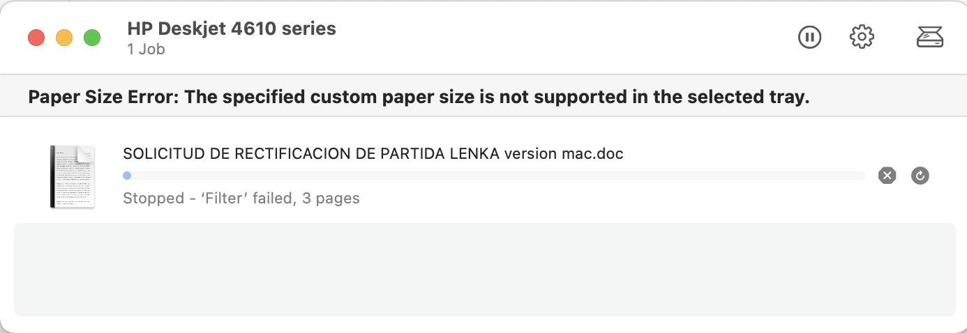

After an Big OS Update my HP DeskJet HP 4615 stoped working , it displays the next error: "Error in filter" it also display a message saying that the size of the paper is not supported by the printer, but i'm using A4 paper.
Two moth ago I also had problems with the same printer, I updated the printer driver and it started working, but not it doesn't work.

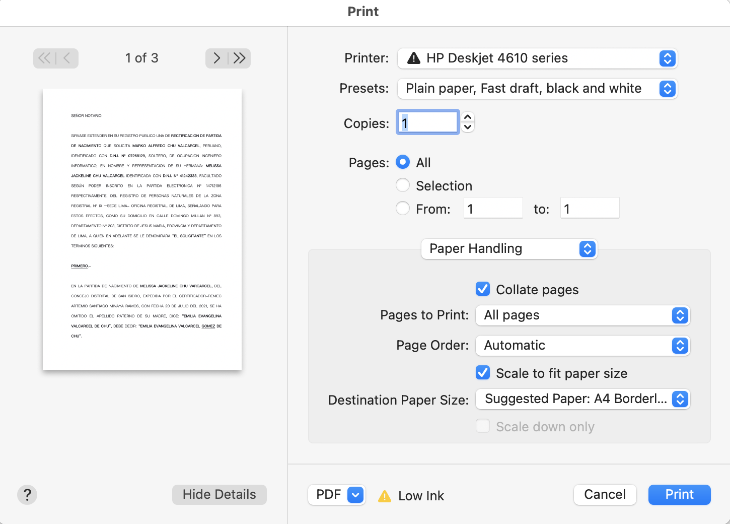

It looks like issue on paper size. Have you tried save the doc to pdf first, and print from Preview app? I had few times success using this workaround.

Thank you, it worked, if I print a PDF it works, but if I print using WPS office , my daiyli office program it doesn't, but if I select the option "scale to fit paper size" it works, maybe the WPS is not compatible with Big Sur 11.4, I used my printer 6 weeks ago and it worked.
