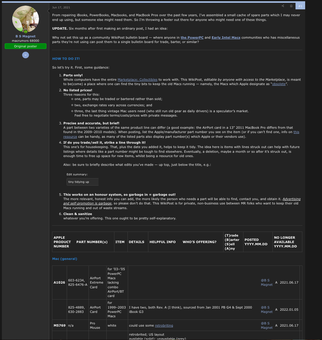

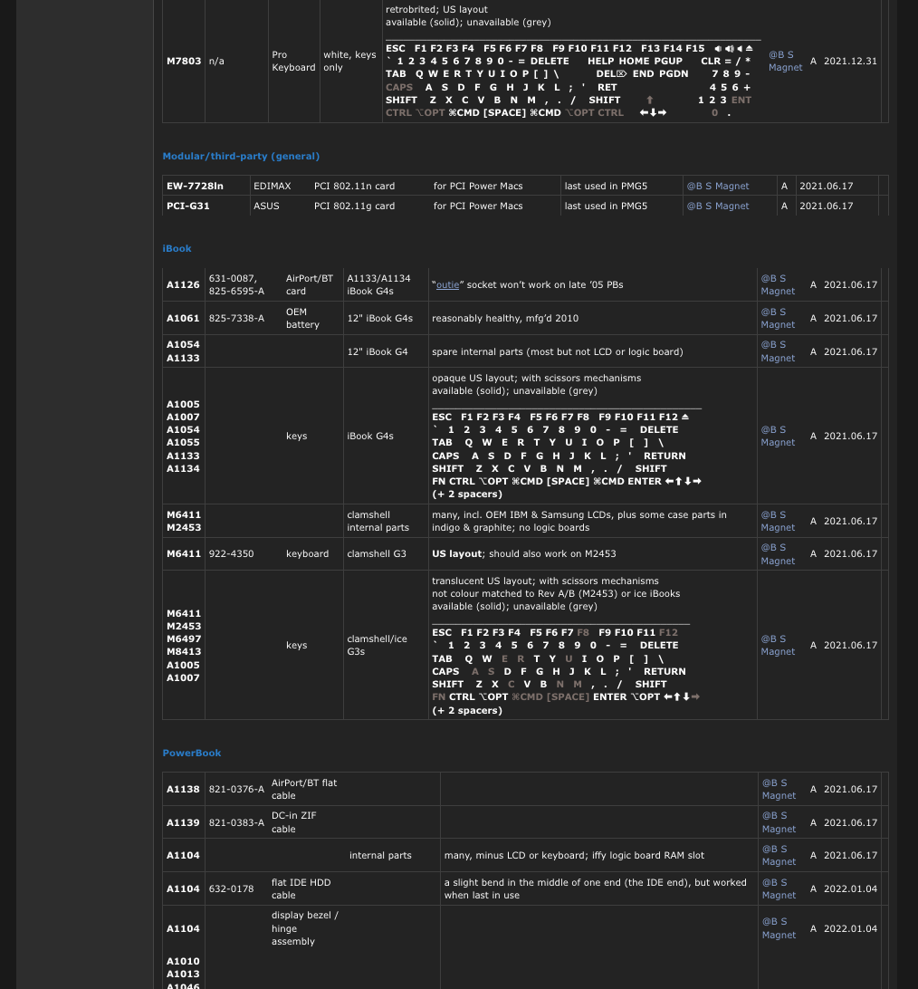

To @devinpfox :
Following up on what @lepidotós wrote, if you do follow the path of gutting an old iMac G3 of its original internals, it is wise not to dispose of them, as they’re now very much hard-to-come-by components needed for surviving iMacs. Instead, may I offer that you add those spare parts to this WikiPost for when the time comes?
(Note: right this moment you won’t be able to view it — you need at least 6 months on here and at least 250 posts — but you ought to bookmark this post to reach the link when you’re parting out the original components from the donor iMac G3 on which you and your friend plan to do this project. Below are some screen caps from this new MR forums community project. It’s a kind of editable community bulletin board for posting available vintage Mac parts typically too small to merit creating new threads: )
(…and so on)
Cheers.
