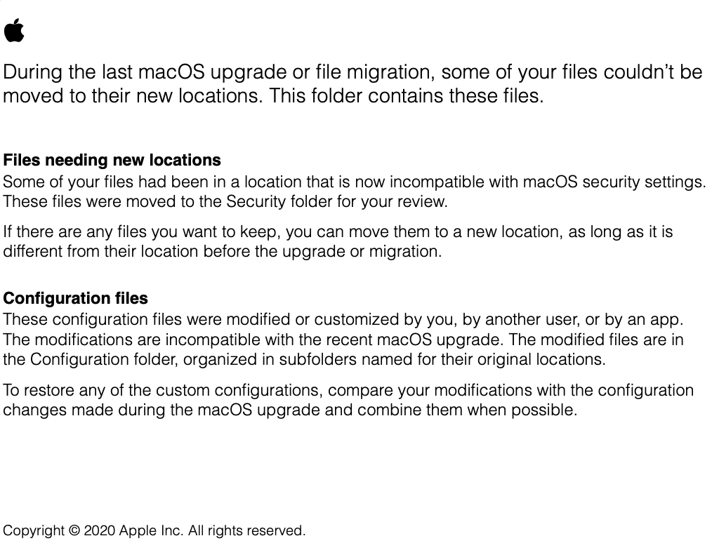

I had this same problem and thought my files were lost forever. I finally figured out what happened. The files got relocated to a folder for some reason. On my drive they're in this folder path Users/Shared/Relocated Items/Security/
In the Relocated Items folder there was this document explaining why the files relocated. Anyways, hope this helps someone!
