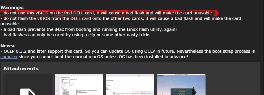

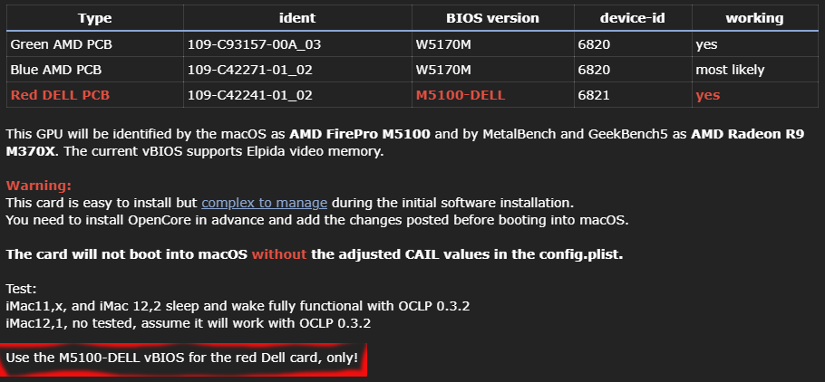

Hello.. So i'm looking to upgrade my mid 2010 imac 21.5 11,2 and i come across AMD M5100 doing my research.. I found the vbios here:
I'm confused.. First it says "Use the M5100-DELL vBIOS for the red Dell card, only!" then when you scroll down there's a warning " do not use this vBIOS on the Red DELL card, it will cause a bad flash and will make the card unusable"
SO DO I FLASH IT OR NOT? LOL I Don't understand.. I need to know if i should purchase that card on ebay or not...Am i misunderstanding something or is there an error in that post? LoL

It depends on the color of the card and the type of memory of it.
The vBIOS attached here supports Elpida memory.
There is another vBIOS with Hynix BFR memory support.
And there is a third vBIOS with Hynix AFR memory support.

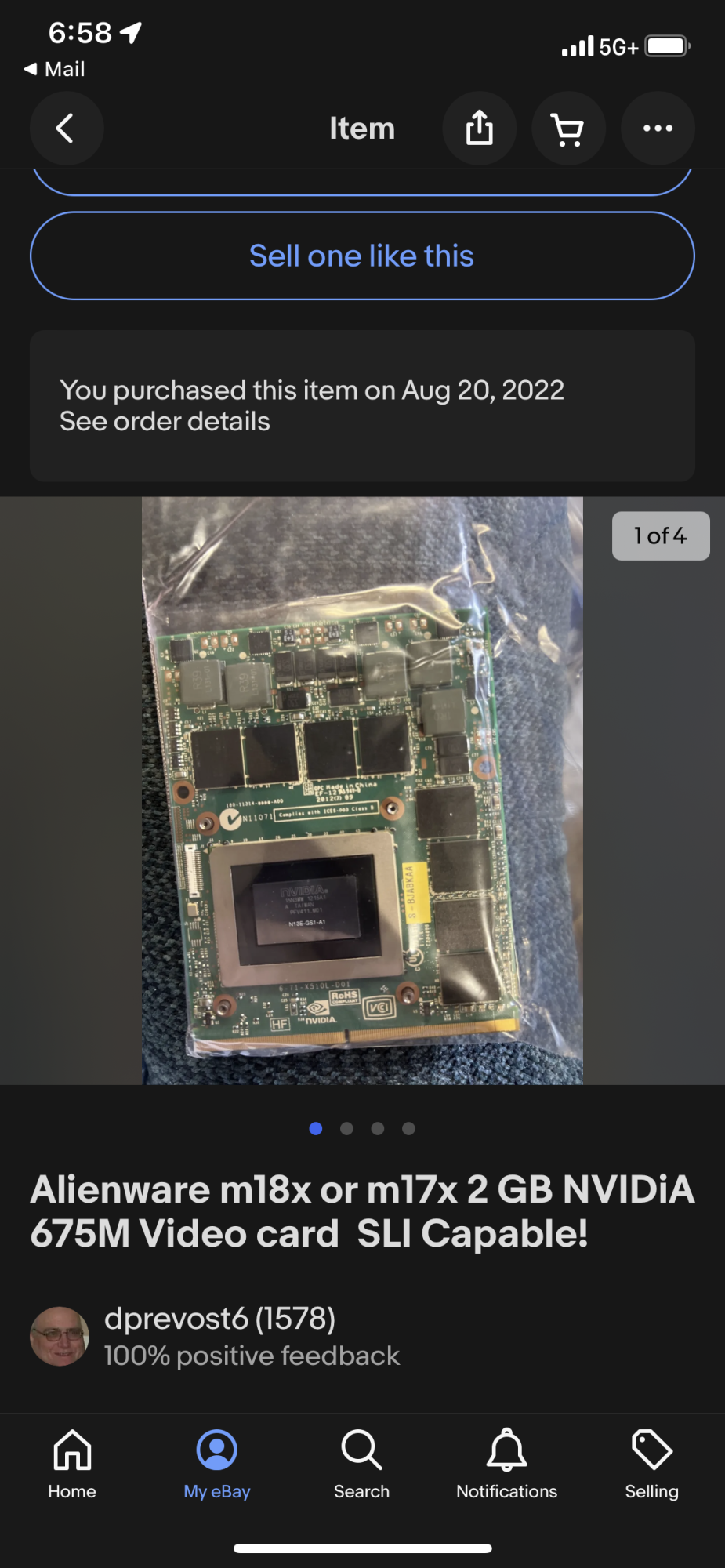

Hey mad vinegar thanks for the response buddy. I thought I read something that said if I installed open core before I installed the card I would be able to get high Sierra to load without flashing the card. I am not too worried about an apple logo or boot screen at the moment. I can attempt the flash from a putty terminal on my laptop. I thought the flash was for boot screen etc. Apparently installing the card and putting everything back together and pressing power, waiting, doesn't work. I am pretty sure the memory is Hynix. Ill see what the chip says.
The photo you uploaded is from an Nvidia 675m, not from an AMD m5100. 🤷‍♂️🤷‍♂️🤷‍♂️🤷‍♂️
