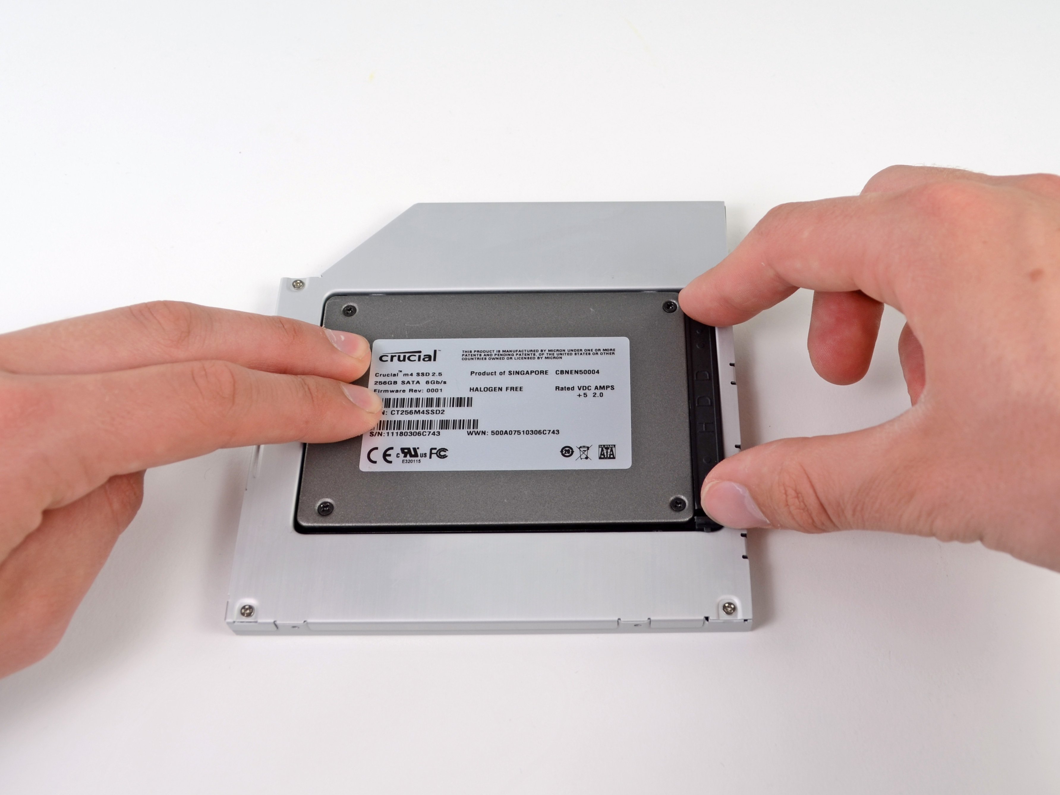

You can always move them back and reboot, but you’ll get the main problem.
There’s only one bulletproof solution is to disconnect the optical drive physically.
